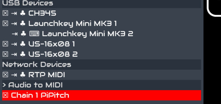

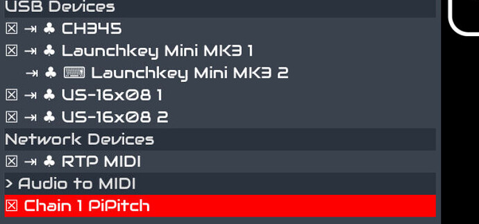

[Edit] I have simplified the process:
  • Add audio to MIDI processor to audio chain.
  • In chain manager, click the “MIDI Input” box for a MIDI or Instrument chain.
  • Select the MIDI input from the Audio to MIDI section of the list.
    Any audio processors with a MIDI output should appear in this list.
