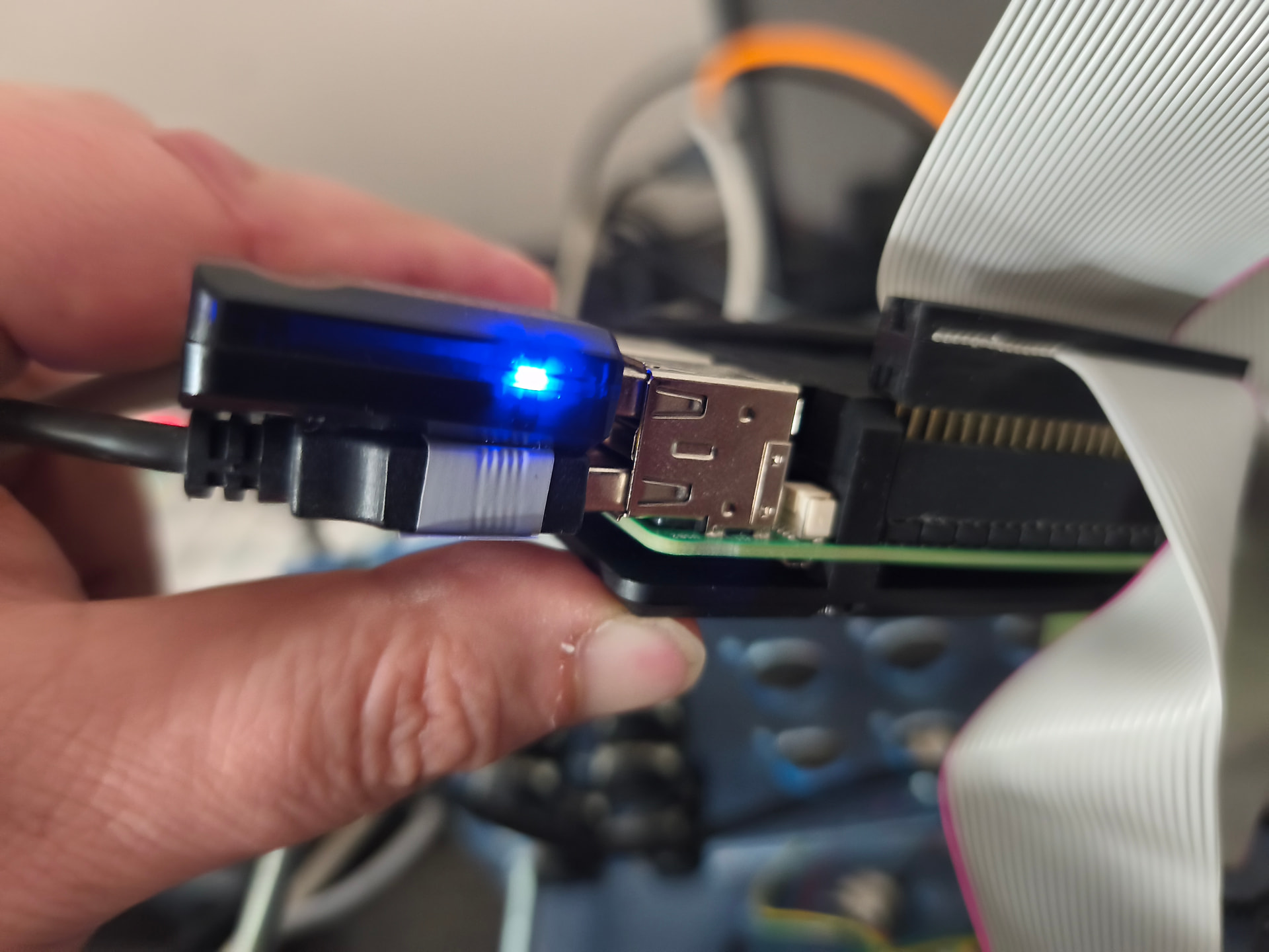

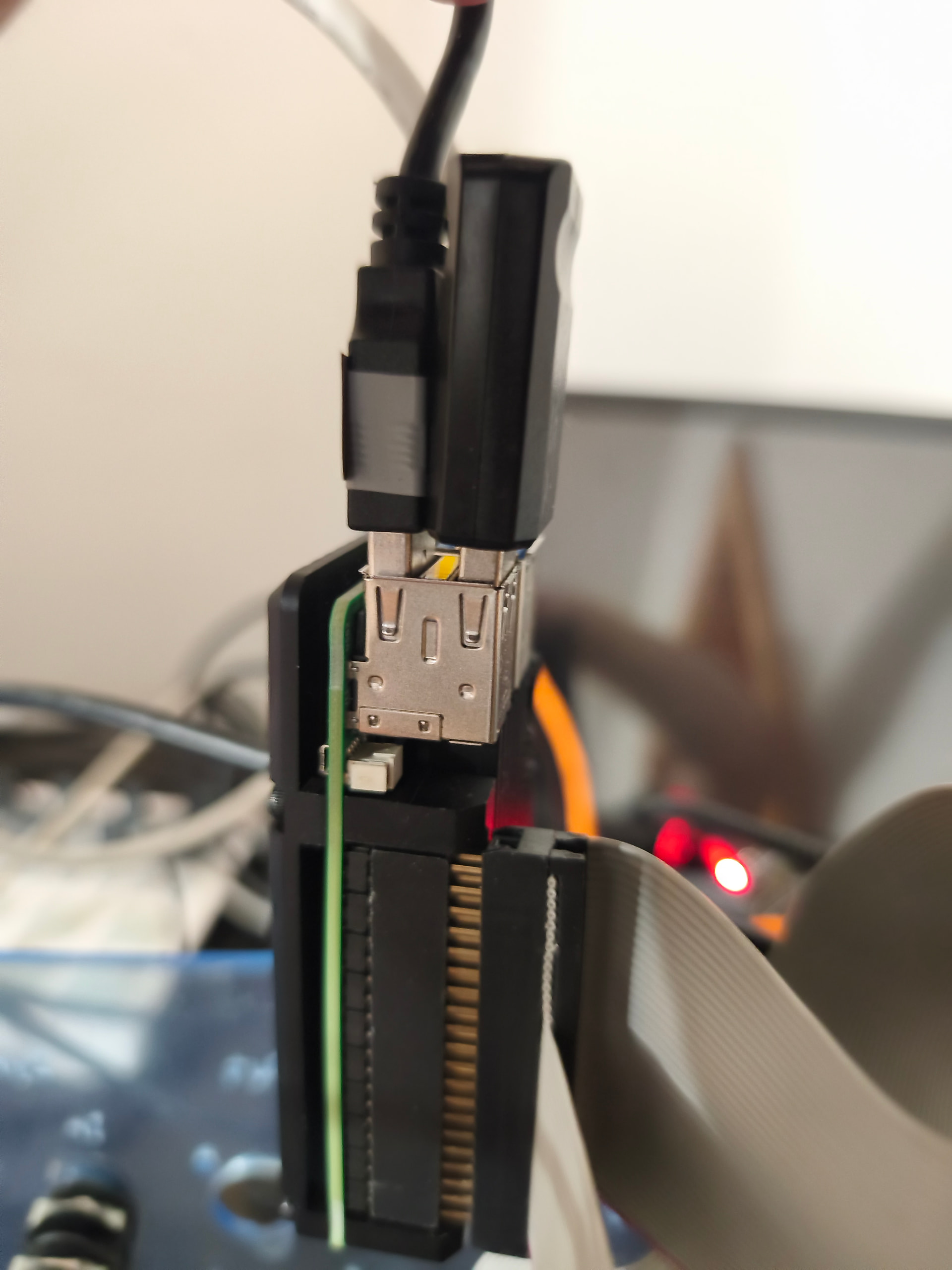

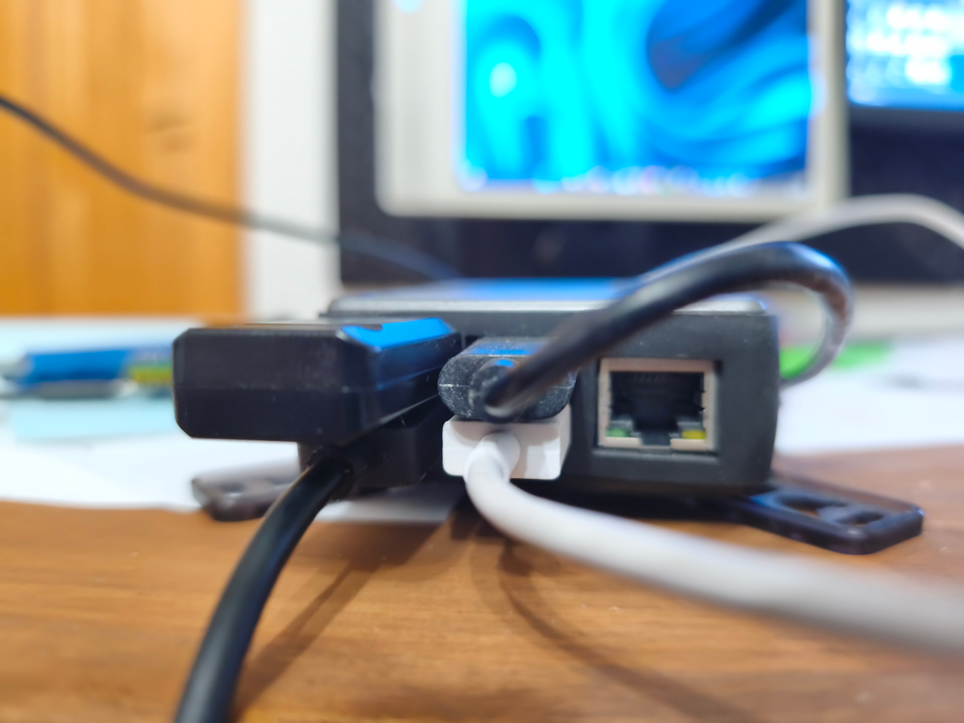

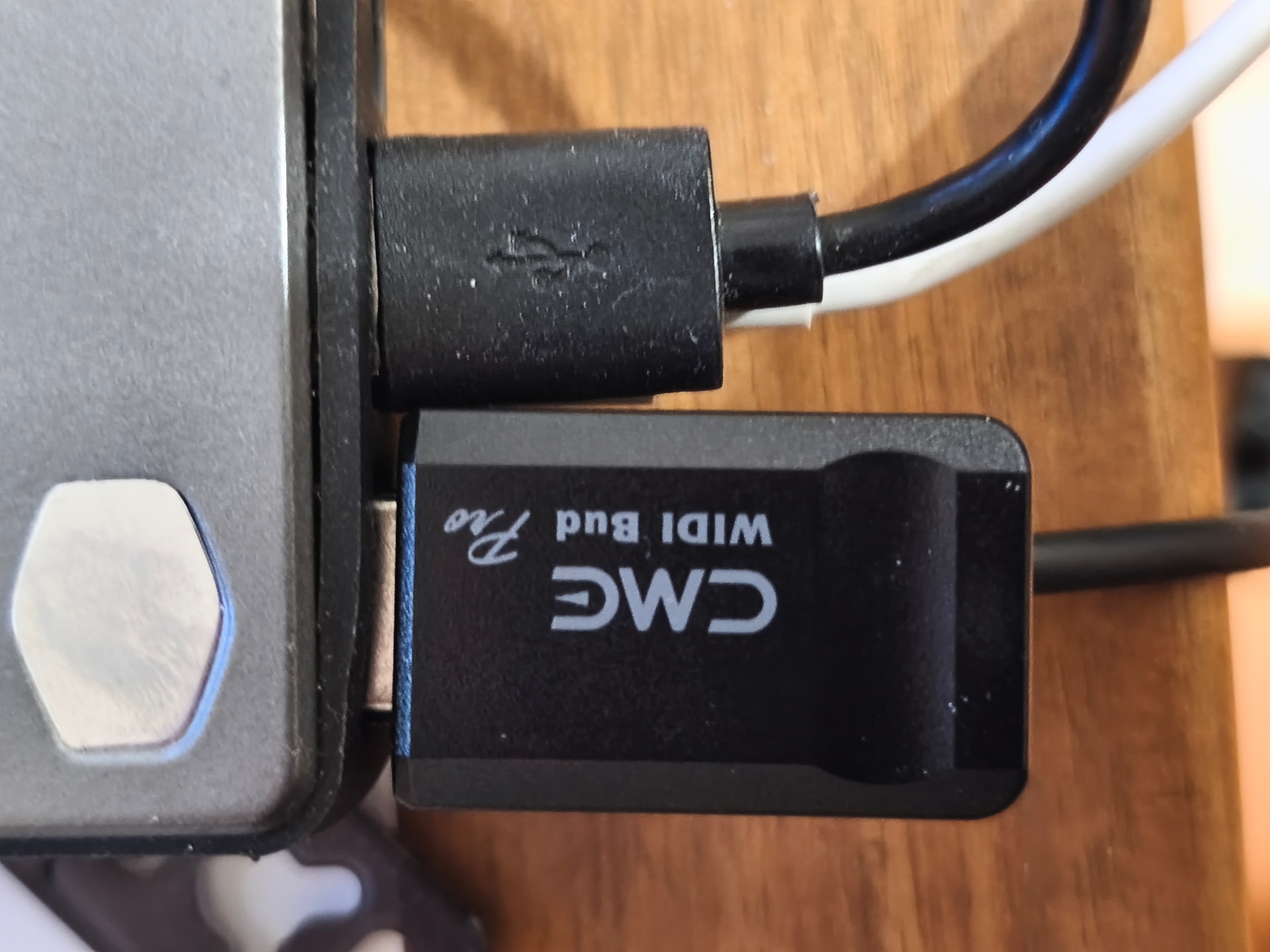

Hi @ToFF, do you know if the WIDI Bud pro blocks the USB port next to it when used on a Zynthian/Raspberry PI?
Hi @jawn,
It’s a little thicker than optimal, but it’s possible with the cables around it. So I normally have it in a USB hub.
