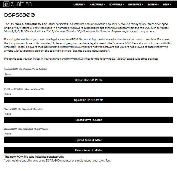

I have switched to vangelis, but the presets for Vavra and Xenia are not in the presets directory. Is there anything else I need to do to add them? Also, although I can upload roms for Xenia, the upload for Vavra is not working - it says it is uploaded but it is not displayed in the web interface, and the plugin does not work. Where should the rom files be installed to in the directory structure?

Ok. Here it is:
zyncoder: vangelis (e903d39)
zynthian-ui: vangelis (3ce1900)
zynthian-sys: vangelis (eac724c)
zynthian-data: vangelis (8b55ea8)
zynthian-webconf: vangelis (7a43686)
In Webconf choose Software->Engines
In the tab MIDI Instrument scroll down the list until you find Osirus and set the mark.
Reload Webconf by clicking the Zynthian icon on top left. (Already tried with reboot, but outcome is the same.)
In Webconf choose Software ->DSP56300
The page shows the etire list of all possible DSP56300 emulators, not only the one that has been activated. In Oram, only the previously activated emulator would show.
All file fields show none, as expected, when nothing has been uploaded yet.
Choose Upload Osirus ROM file. A new window opens, Drop files here or click and choose, either operation will result in showing the filename underneath the ant-lined area.
Press UPLOAD.

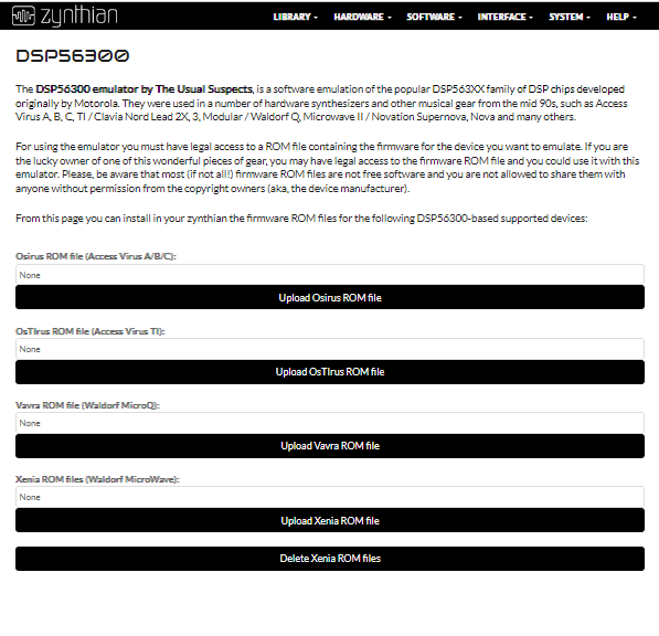

A Progress bar runs through, looks like it does not reach the end before the black window closes and the previous page shows up like this:
Note, the Osirus filename field still shows none. I’ve checked the binary with the pulled chip. It works perfectly in Oram, but in Vangelis it does not.
The Osirus can be added in Instrument Chain, but it does not work and has no presets. In Oram, it has presets and it works.
If trying the Xenia and Vavra with the files provided on the Waldorf website Legacy Microwave II / XT / XTk Series – Waldorf Music and Legacy Micro Q Series – Waldorf Music, the same outcome.
PS: Please do not ask for the binary. I have the original hardware and I won’t engage in copyright infringement.
