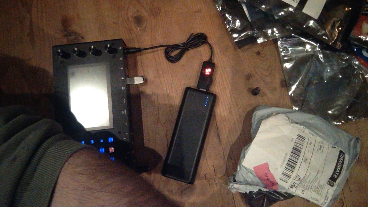

I remembered today that I still have some of these laying around:
Not as fancy as PD and @JayBee’s cable, but my powerbank only does QC3.0…
They’re rated for 10W, and a quick test showed the V5 draws around 7W (with several synth channels active):
No undervoltage problems so far. I’ll do an endurance test tomorrow. Might still get hot.
this is just … excellent
:+1:
[edit] With display on ?[/edit)
Yes, I tried to reach a high load… Didn’t try recording, but I doubt that would change much…

Thanks for the tip! These work lovely!

For those wondering: Bought this cable to try it and it works
I can now enjoy my Zynthian even without being at home :blush:
