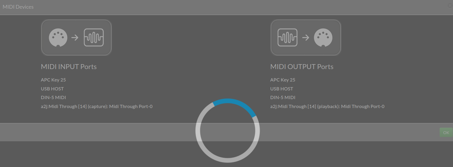

Hi all, I’m trying to write a driver for the first version of the akai APC Key 25. I made a copy of the zynthian_ctrldev_akai_apc_key25_mk2.py into zynthian_ctrldev_akai_apc_key25.py. In this file I properly changed dev_ids = [“APC Key 25”, “APC Key 25 MIDI 1”] according to the output of dmesg and amidi -l, finally I added the corresponding entry into init.py
I finally systemctl restart zynthian, but unfortunately nothing happened!
Suggestions to debug?
Thanks in advance, Andrea

Thanks a lot … I tried the following
systemctl stop zynthian
/zynthian/zynthian-sys/sbin/zynthian.sh
During the boot
INFO:zynthian_ctrldev_manager.update_available_drivers: Ctrldev driver 'zynthian_ctrldev_akai_apc_key25' for devices with ID 'APC Key 25'
INFO:zynthian_ctrldev_manager.update_available_drivers: Ctrldev driver 'zynthian_ctrldev_akai_apc_key25' for devices with ID 'APC Key 25 MIDI 1'
So the drivers are at least considered … but it is not clear to me whether are properly loaded and how to check it
Might it be that the mapping of mk2 is completely different from the first version?
How can I check the driver indeed intercept the events generated by the keyboard?
Thanks

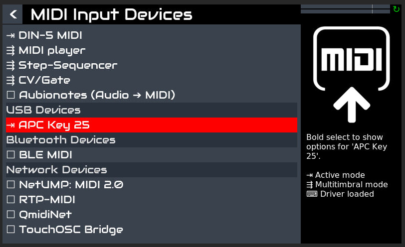

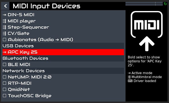

Can you see the device available in Midi Input Devices? Look for the “keyboard” icon.
Do you mean? … there is no “keyboard” icon
On the Zynthian screen you can the the device two times. One with the little keyboard is the device with driver, and the one without is the classic midi device as it.
I don’t know if that can be enabled using the webconf. What i mean is this:
There is no keyboard icon! but apparently the driver is loaded
