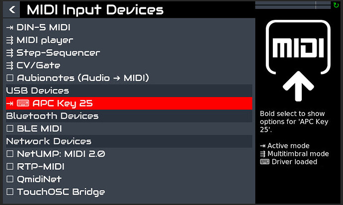

Bold press there, and enable your driver in the menu that appears…

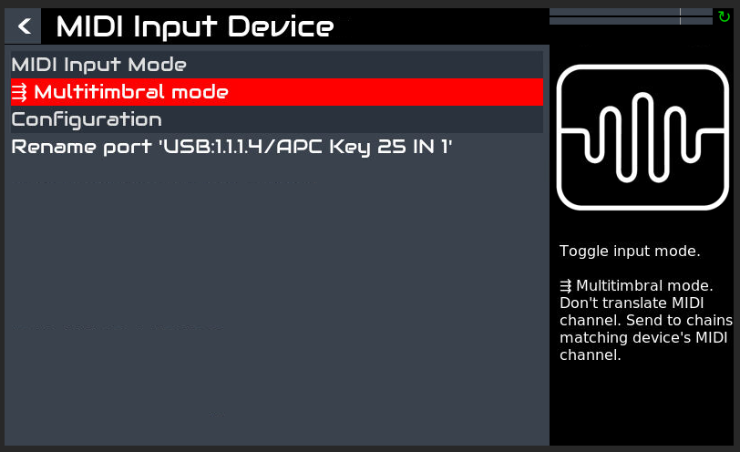

I can change the Midi Input Mode or the Configuration, but I cannot activate the driver
So I guess I miss something since the driver is not available

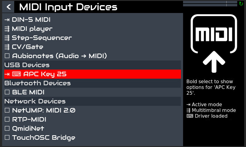

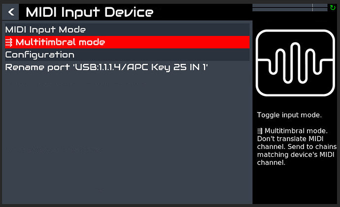

Then it may be a mismatch with the IDs. Did you see exactly the same label in the logs and in your dev_ids? Did you set the ZYNTHIAN_LOG_LEVEL=10? Maybe trying with APC Key 25 IN 1
You are right
these are the correct ids
and eventually
Thanks a lot for your support … I will play a bit with it to see how it works and I’ll keep the community updated
