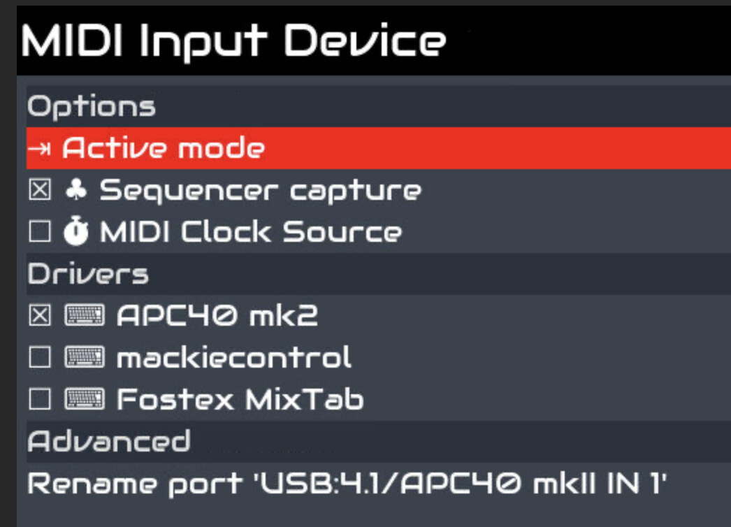

I’ve just switched to Vangelis and noted the APC40 feature. I have an APC40mkii, plugged it in, and it’s configured as shown, but it’s only displaying default lights on the device and isn’t responding on zynthian. Is there something else to do?
It should work out the box.
Please, send the UI logs to see what is failing.
i think mine behaved like that the very first time i hooked it up. It felt like som kind of usb port logistic problem that i think i solved with unplugging plugging booting and rebooting in some kind of magic order. But you have probably tried that :wink:
UI Log.rtf (9.1 KB) Here you go.
Update, about 4 or 5 reboots later, it seems to be working. No idea why!
It’s just honouring your perseverance.
Nope, not working again. Trying a few more reboots, but no joy so far.
I see too many issues in your log. Could you test with a fresh burned Image updated to Vangelis?
