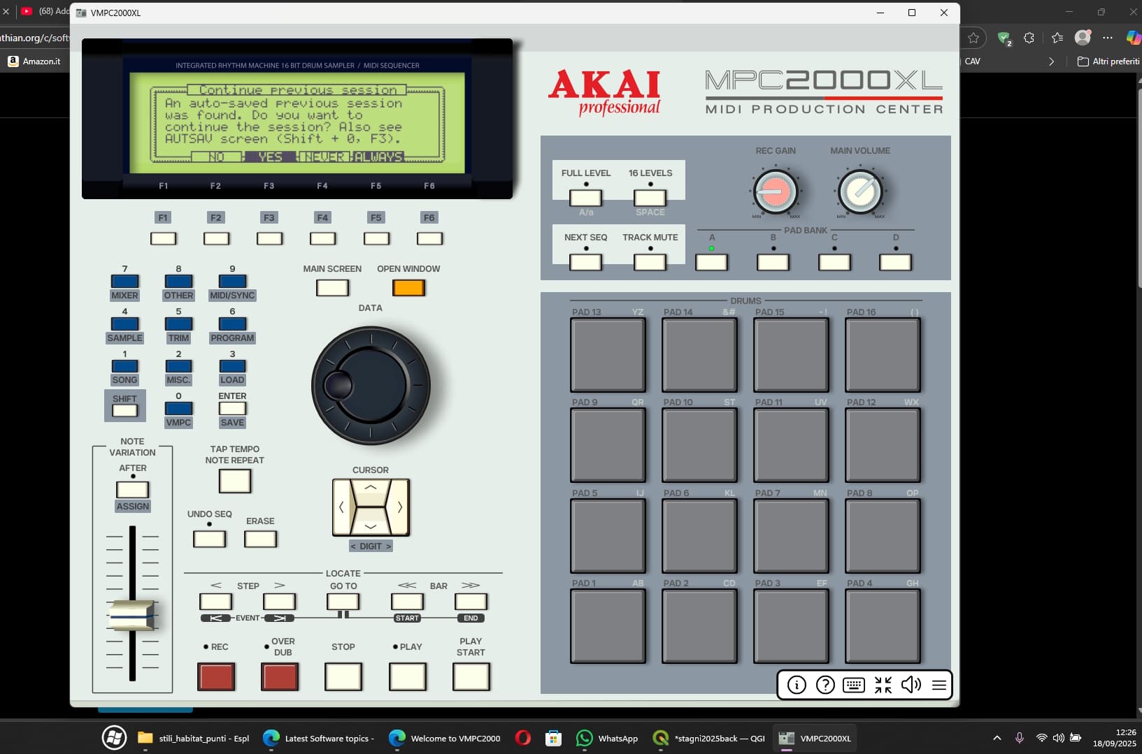

I donloaded the Windows version. Didn’t test it yet but it looks nice. :grinning_face:

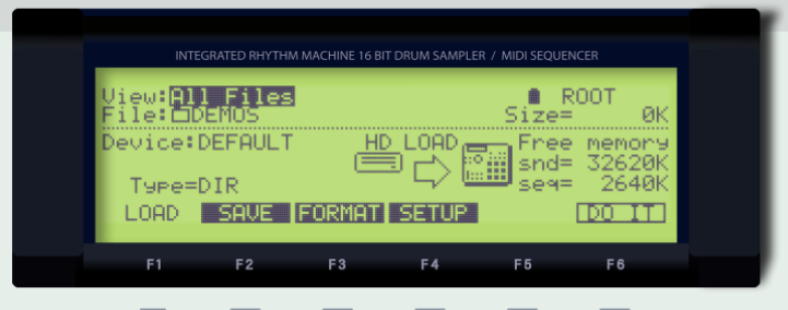

Are these buttons or lights? They don’t respond at all
Hi @HansR
There hardly any feedback… look at the display:
1 shift + 3 … display should show:
2 press cursor right on the GUI → ROOT is highlighted
3 press F6 (= one directory lower…) and press F6 again… you will see “RESIST” as directory
name
4 Go with cursor key to where it is stated: “File:”
5 turn the selection wheel and select: RESIST.ALL and press F6 and then F5
6 turn the selection wheel and select: RESIST.APS and press F6 and then F5
Now the sounds and sequences are loaded…
You can play the squences by prssing the play button at the bottom (sorry…)
Also… the samples are connected each to a key (in the low range) so you can also play the via the (piano) keyboard
Good luck!
Cheers,
Maarten
Yes, i have sound. Thanks for your guidance!
It took a considerable time before I understood this means shift + 3 on the computer keyboard, not pushing the shift and 3 “buttons” in the GUI
Well, it’s an interesting device. Thanks again Maarten.
