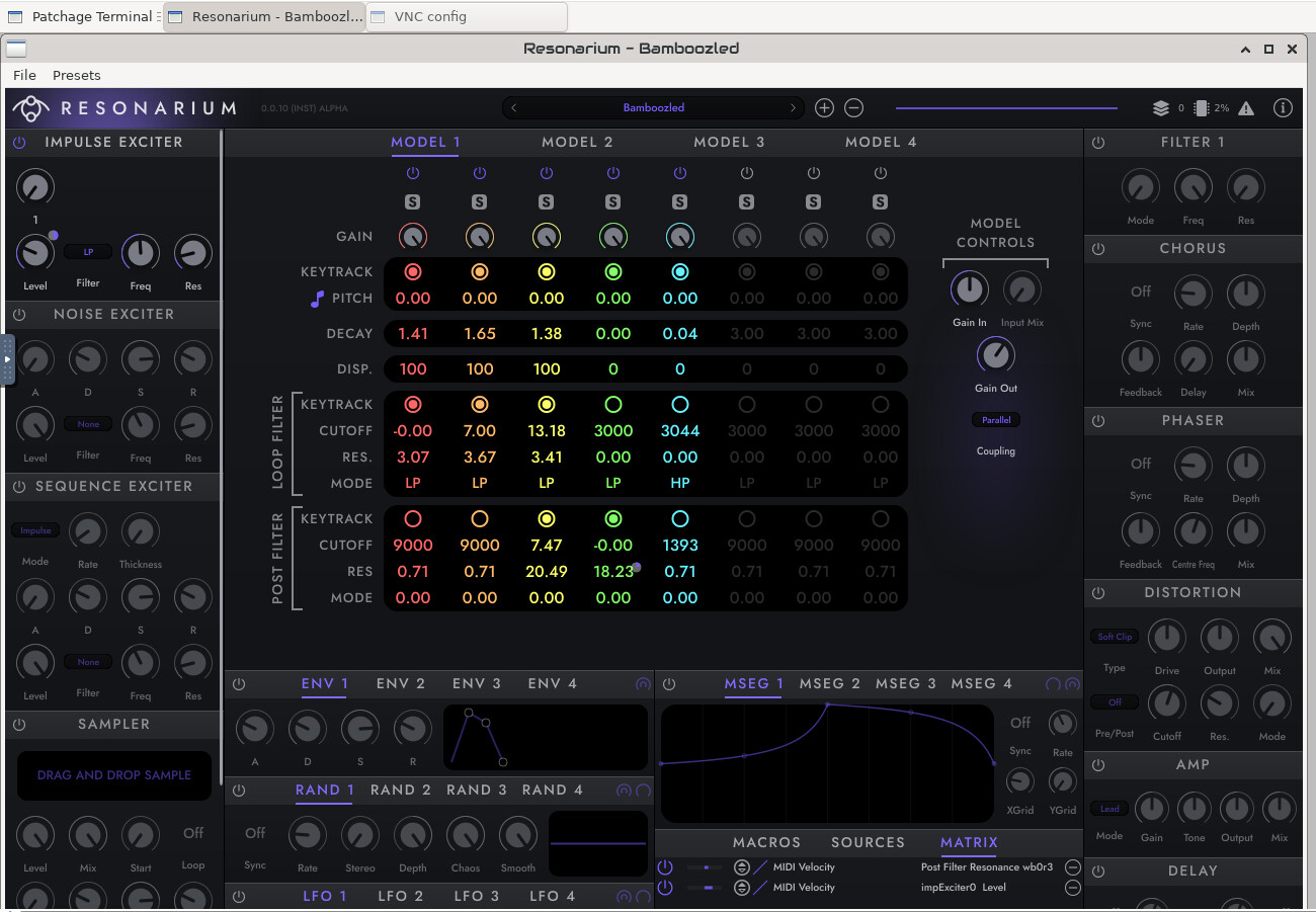

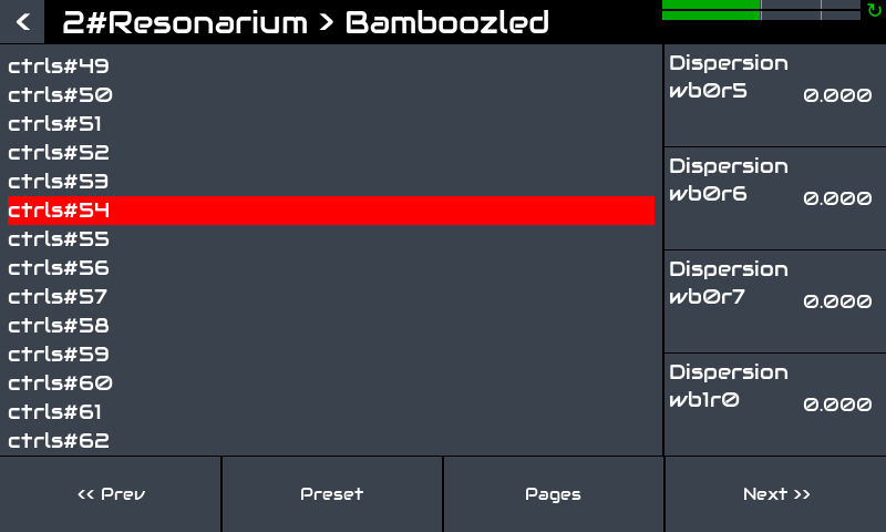

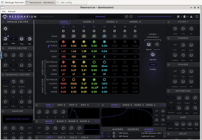

It takes a long time to compile but it works!
The presets are there but also a lot of “-” blank presets. It is easy to driver the synth into CPU overload which then kinda crashes - maybe jackd. No audio and orange health indication. I rebooted. This is interrupting me listening to the cricket coverage (on BBC Radio via zynthian internet radio player).
You have been warned!
