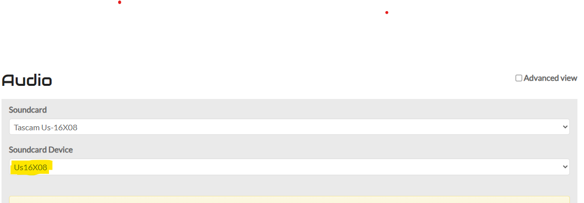

Are you trying to use the Tonex as the primary audio interface by selecting it in webconf or as a secondary audio interface using audio hotplug?
For the former, you should be able to select it from the dropdown titled “Soundcard Device” as highlighted in this screenshot:
You will have to select the Audio Input and Output routing in each chain’s Audio In/Out menus.
If the latter then it should appear as an interface in teh Hotplug Audio menu where it can be enabled. Then you need to route inputs and outputs in chain Audio In/Out menus.
