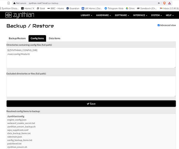

You can get creative with the backup utility, using Advanced options.
It has never really had a solution to lots of big files, and so the separation of config & data is useful.
I tend to start with a config just to see if everything is behaving itself, but that’s more for my benefit than zynthians. The backups tend to simply go into a directory structure on a remote disk, and are rarely touched.
The irony of my browser regarding zip files created on my own machine as suspect and worthy of blocking is both amusing and a tiny bit chilling.
Thanks @wyleu
I checked the advanced options on the Backup/Restore tab, but that had no effect.
I hadn’t noticed that the Configuration and Data Items tabs also had these advanced options.
Enough to get creative with.

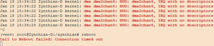

Hi @HansR
From your screenshot, this really looks like a hardware (disk) failure !
What I actually would love would be an internal backup/restore to connected usb drive. Data backup/restore works perfectly with webconf, but user data including soundfonts is very big and fails often, so the usb solution would be neat.
Agreed, but it happened with two different SD cards, so I suspect it’s a hardware failure caused by software.
