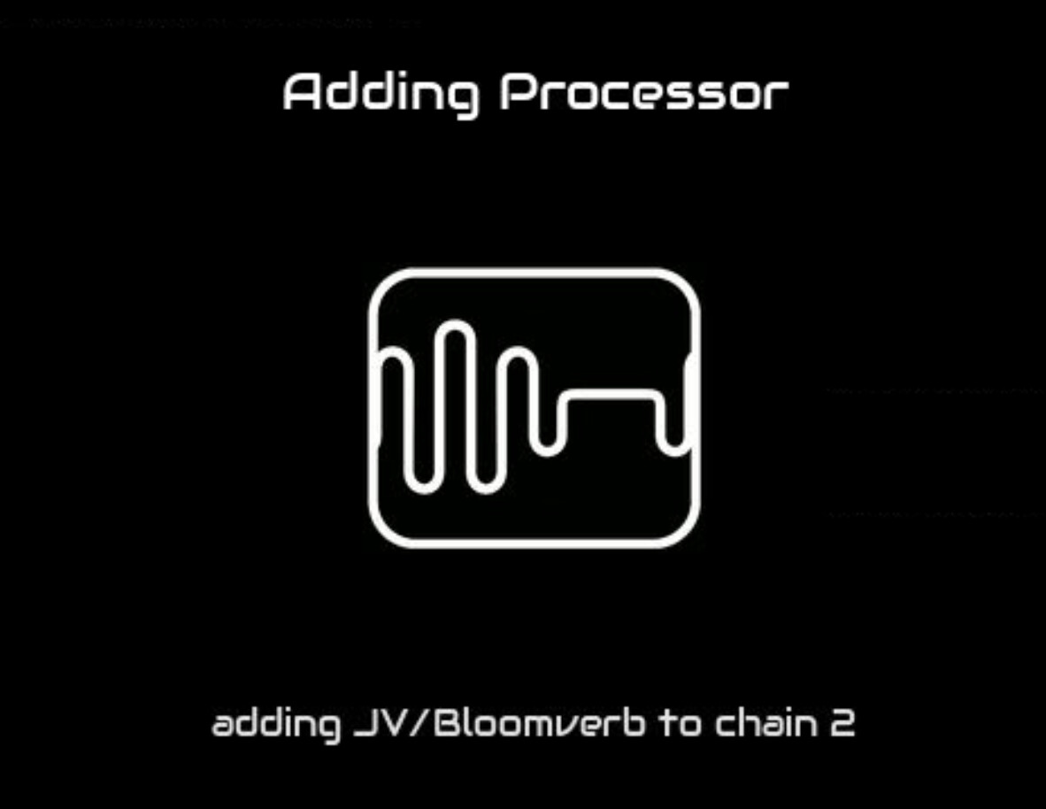

I tried to load you plugin, but it gets stuk while loading.
(I am on the latest vangelis version)

Hi @micahvdm ,
Thanks for your effort to fix your plugin.
However, when trying to load the plugin, my zynthian still gets locked up.
