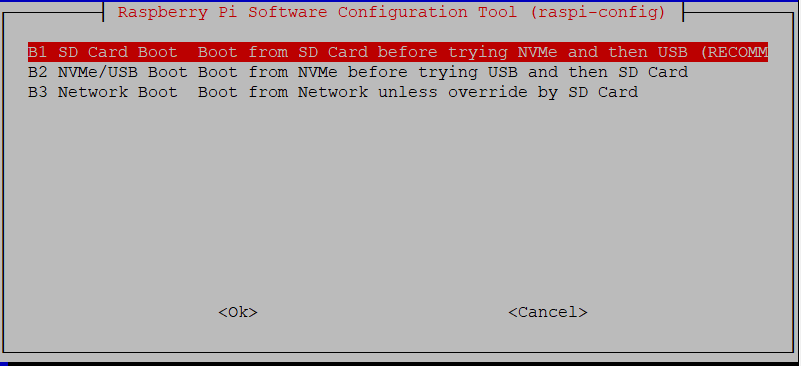

I’ve got a custom zynthian based on pi 5 in a case Argon Neo 5 Nvme. We have two options to configure boot order: B1 and B2. Choosing B1, whenever a sd card is plugged in, zynthian will boot from there avoiding to boot from nvme where is my “production” system. Choosing B2, zynthian will boot from nvme but, unless my nvme has problems booting, never will boot from sd.
I wonder if it’s possible to change boot order as follow: USB, SD, Nvme.
Best Regards.
@smespresati By entering with Putty and typing “raspi-config” on the terminal, you access the startup settings and if I remember correctly there are 3 options among which I think the one you are looking for.
Thanks @Lanfranco the third option is for booting from the network.
Sorry… I didn’t have a Raspberry Pi nearby, so I tried to remember, but I couldn’t. Someone in the group will give you the right answer soon.
Search for EEPROM order to get a number of posts.
Thanks @jawn, searching for EEPROM I found this post that helped me. Now my first boot device is USB.

  • On terminal, type sudo raspi-config, and make sure that B1 is the set boot sequence (first SD, then nvme).
