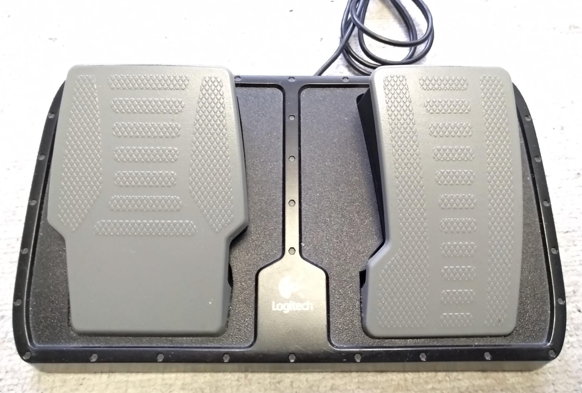

Fwiw, I got this at our local thrift store for €4,50. It’s a used double analog pedal (used for racing games)
The analog part I like most, it’s far more versatile than an on/off button.
I connected it to an Arduino pro-micro’s AD converter and that sends out USB MIDI over arbitrary channels and with arbitrary CC’s.
Just an idea, It should be doable for someone who restores guitars :wink:
