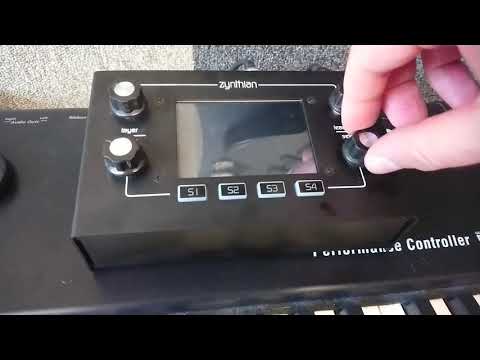

After building my brand new V4 I’ve been playing around for a few hours. I noticed that the select encoder started to feel (and sound) different from the others, more flimsy. Also sometimes when scrolling down at first the selection on the screen moves up and visa verse.
Is this a known problem or do I have a bad encoder by accident? The small pcb and screws are secure, I opened it up to check if they somehow had gotten loose.
I made a little video to demonstrate (hidden link, no bad publicity
Please advise.

Encoders are far from perfect and sometimes it can be a little jumpy, although normally you get used to this and your fingers learn to avoid it. I would like to use better encoders, but good encoders are quite big and really expensive!!
You could try to swap by another one, less important than “select”, like “layer” or “snapshot”. Anyway, if you feel that it’s too uncomfortable, tell me and i will send you a new one.
My select encoder also sometimes makes a step in the wrong direction.
Swapping it is a good idea as a quick fix if it maybe will get worse.
