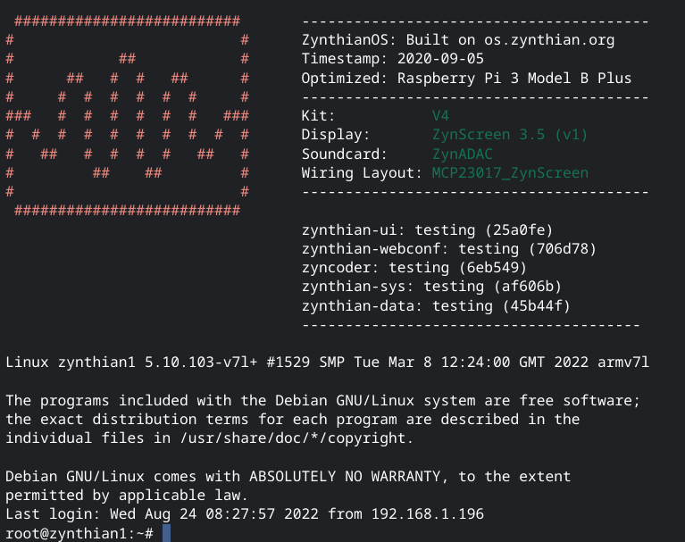

Hi@jofemodo
That fixed it, sorry about the detail. I did paste the configuration at the top of the webconf log file I attached but maybe that wasn’t what you were looking for?
Anyways, my Zynthian is what you call V1. It is custom built RPI4B with KY40 encoders directly wired to GPIO. Audio is Hifiberry DAC+ADC Pro, midi side is a hacked Arduino Midi shield attached to Rx,Tx on GPIO and the display is Generic HDMI attached to a 7” monitor. I am trying my best to keep it on the testing branch but I’ve had issues as the community develops for the future. I don’t need extra switches or CV outputs etc……I have a few midi controllers that can take care of all my needs, even have a controller that outputs qwerty. I really like the zynmixer so that is why I wanted to move to testing. I’ve attached a pic of my box.
Thanks again for your work and patience.

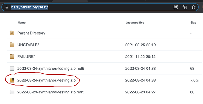

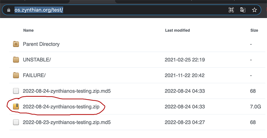

I downloaded the latest test branch on 08/24/2022, installed in a new SD card, everything works except webconf.

Aug 24 14:27:35 zynthian systemd[1]: Started Zynthian Webconf.
Aug 24 14:27:34 zynthian systemd[1]: Stopped Zynthian Webconf.
Aug 24 14:27:34 zynthian systemd[1]: zynthian-webconf.service: Scheduled restart
Aug 24 14:27:34 zynthian systemd[1]: zynthian-webconf.service: Service RestartSe
Aug 24 14:27:29 zynthian systemd[1]: zynthian-webconf.service: Failed with resul
Aug 24 14:27:29 zynthian systemd[1]: zynthian-webconf.service: Main process exit
Aug 24 14:27:29 zynthian zynthian_webconf.sh[7766]: ModuleNotFoundError: No modu
Aug 24 14:27:29 zynthian zynthian_webconf.sh[7766]: import terminado
Aug 24 14:27:29 zynthian zynthian_webconf.sh[7766]: File "./zynthian_webconf.p
Aug 24 14:27:29 zynthian zynthian_webconf.sh[7766]: Traceback (most recent call
Aug 24 14:27:29 zynthian systemd[1]: Started Zynthian Webconf.
Aug 24 14:27:29 zynthian systemd[1]: Stopped Zynthian Webconf.
lines 1-23…skipping…
– Logs begin at Wed 2022-08-24 13:12:11 BST, end at Wed 2022-08-24 14:27:40 BST
Aug 24 14:27:40 zynthian systemd[1]: Started Zynthian Webconf.
Aug 24 14:27:40 zynthian systemd[1]: Stopped Zynthian Webconf.
Aug 24 14:27:40 zynthian systemd[1]: zynthian-webconf.service: Scheduled restart
Aug 24 14:27:40 zynthian systemd[1]: zynthian-webconf.service: Service RestartSe
Aug 24 14:27:35 zynthian systemd[1]: zynthian-webconf.service: Failed with resul
Aug 24 14:27:35 zynthian systemd[1]: zynthian-webconf.service: Main process exit
Aug 24 14:27:35 zynthian zynthian_webconf.sh[7772]: ModuleNotFoundError: No modu
Aug 24 14:27:35 zynthian zynthian_webconf.sh[7772]: import terminado
Aug 24 14:27:35 zynthian zynthian_webconf.sh[7772]: File "./zynthian_webconf.p
Aug 24 14:27:35 zynthian zynthian_webconf.sh[7772]: Traceback (most recent call
Aug 24 14:27:29 zynthian systemd[1]: zynthian-webconf.service: Scheduled restart
lines 1-24…skipping…
– Logs begin at Wed 2022-08-24 13:12:11 BST, end at Wed 2022-08-24 14:27:40 BST. –
Aug 24 14:27:40 zynthian systemd[1]: zynthian-webconf.service: Scheduled restart job, restart counter is at 823.
Aug 24 14:27:40 zynthian systemd[1]: zynthian-webconf.service: Service RestartSec=5s expired, scheduling restart.
Aug 24 14:27:35 zynthian systemd[1]: zynthian-webconf.service: Failed with result ‘exit-code’.
Aug 24 14:27:35 zynthian systemd[1]: zynthian-webconf.service: Main process exited, code=exited, status=1/FAILURE
Aug 24 14:27:35 zynthian zynthian_webconf.sh[7772]: ModuleNotFoundError: No module named ‘terminado’
Aug 24 14:27:35 zynthian zynthian_webconf.sh[7772]: File “./zynthian_webconf.py”, line 34, in
Aug 24 14:27:35 zynthian zynthian_webconf.sh[7772]: Traceback (most recent call last):
Aug 24 14:27:34 zynthian systemd[1]: zynthian-webconf.service: Scheduled restart job, restart counter is at 822.
Aug 24 14:27:34 zynthian systemd[1]: zynthian-webconf.service: Service RestartSec=5s expired, scheduling restart.
Aug 24 14:27:29 zynthian systemd[1]: zynthian-webconf.service: Failed with result ‘exit-code’.
Aug 24 14:27:29 zynthian systemd[1]: zynthian-webconf.service: Main process exited, code=exited, status=1/FAILURE
Aug 24 14:27:29 zynthian zynthian_webconf.sh[7766]: ModuleNotFoundError: No module named ‘terminado’
Aug 24 14:27:29 zynthian zynthian_webconf.sh[7766]: File “./zynthian_webconf.py”, line 34, in
Aug 24 14:27:29 zynthian zynthian_webconf.sh[7766]: Traceback (most recent call last):
Aug 24 14:27:29 zynthian systemd[1]: zynthian-webconf.service: Scheduled restart job, restart counter is at 821.
Aug 24 14:27:29 zynthian systemd[1]: zynthian-webconf.service: Service RestartSec=5s expired, scheduling restart.
Aug 24 14:27:24 zynthian systemd[1]: zynthian-webconf.service: Failed with result ‘exit-code’.
Aug 24 14:27:24 zynthian systemd[1]: zynthian-webconf.service: Main process exited, code=exited, status=1/FAILURE
Aug 24 14:27:24 zynthian zynthian_webconf.sh[7760]: ModuleNotFoundError: No module named ‘terminado’
Aug 24 14:27:24 zynthian zynthian_webconf.sh[7760]: import terminado
Aug 24 14:27:24 zynthian zynthian_webconf.sh[7760]: File “./zynthian_webconf.py”, line 34, in
Aug 24 14:27:24 zynthian zynthian_webconf.sh[7760]: Traceback (most recent call last):
Aug 24 14:27:24 zynthian systemd[1]: Started Zynthian Webconf.
Aug 24 14:27:23 zynthian systemd[1]: Stopped Zynthian Webconf.
Aug 24 14:27:23 zynthian systemd[1]: zynthian-webconf.service: Scheduled restart job, restart counter is at 820.
Aug 24 14:27:23 zynthian systemd[1]: zynthian-webconf.service: Service RestartSec=5s expired, scheduling restart.
Aug 24 14:27:18 zynthian systemd[1]: zynthian-webconf.service: Failed with result ‘exit-code’.
Aug 24 14:27:18 zynthian systemd[1]: zynthian-webconf.service: Main process exited, code=exited, status=1/FAILURE
Aug 24 14:27:18 zynthian zynthian_webconf.sh[7693]: ModuleNotFoundError: No module named ‘terminado’
Aug 24 14:27:18 zynthian zynthian_webconf.sh[7693]: import terminado
Aug 24 14:27:18 zynthian zynthian_webconf.sh[7693]: File “./zynthian_webconf.py”, line 34, in
Aug 24 14:27:18 zynthian zynthian_webconf.sh[7693]: Traceback (most recent call last):
Aug 24 14:27:18 zynthian systemd[1]: Started Zynthian Webconf.
Aug 24 14:27:18 zynthian systemd[1]: Stopped Zynthian Webconf.
Aug 24 14:27:18 zynthian systemd[1]: zynthian-webconf.service: Scheduled restart job, restart counter is at 819.
Aug 24 14:27:18 zynthian systemd[1]: zynthian-webconf.service: Service RestartSec=5s expired, scheduling restart.
Aug 24 14:27:13 zynthian systemd[1]: zynthian-webconf.service: Failed with result ‘exit-code’.
Aug 24 14:27:13 zynthian systemd[1]: zynthian-webconf.service: Main process exited, code=exited, status=1/FAILURE
Aug 24 14:27:13 zynthian zynthian_webconf.sh[7686]: ModuleNotFoundError: No module named ‘terminado’
Aug 24 14:27:13 zynthian zynthian_webconf.sh[7686]: import terminado
Aug 24 14:27:13 zynthian zynthian_webconf.sh[7686]: File “./zynthian_webconf.py”, line 34, in
Aug 24 14:27:13 zynthian zynthian_webconf.sh[7686]: Traceback (most recent call last):
Aug 24 14:27:13 zynthian systemd[1]: Started Zynthian Webconf.
Aug 24 14:27:12 zynthian systemd[1]: Stopped Zynthian Webconf.
Aug 24 14:27:12 zynthian systemd[1]: zynthian-webconf.service: Scheduled restart job, restart counter is at 818.
Aug 24 14:27:12 zynthian systemd[1]: zynthian-webconf.service: Service RestartSec=5s expired, scheduling restart.
Aug 24 14:27:07 zynthian systemd[1]: zynthian-webconf.service: Failed with result ‘exit-code’.
Aug 24 14:27:07 zynthian systemd[1]: zynthian-webconf.service: Main process exited, code=exited, status=1/FAILURE
Aug 24 14:27:07 zynthian zynthian_webconf.sh[7680]: ModuleNotFoundError: No module named ‘terminado’
Aug 24 14:27:07 zynthian zynthian_webconf.sh[7680]: import terminado
Aug 24 14:27:07 zynthian zynthian_webconf.sh[7680]: File “./zynthian_webconf.py”, line 34, in
Aug 24 14:27:07 zynthian zynthian_webconf.sh[7680]: Traceback (most recent call last):
Aug 24 14:27:07 zynthian systemd[1]: Started Zynthian Webconf.
lines 1-62
lines 1-61

It’s strange because I flashed a new SD card with the lastest tested branch with Etcher, it should work no ?
I downloaded it here :
Hmmm! Something is rather broken with that machine. Does it have Internet connection? Did you leave it to resize its disk and reboot after first boot after installing new image? There is a common issue that this process (which is not obviously indicated) does not complete and the image is corrupt. Also did you use “dd” mode when flashing the image? Other modes tend to fail. I can’t remember if Etcher offers the dd option and have a vague (and possibly false) memory of some versions of Etcher not working (for everyone). The last image I flashed I used Raspberry Pi Imager.

So it works now, thanks a lot Riban! But something is still strange, I downloaded the latest tested branch, and i did what you said, this time I flashed my SD with “Raspberry Pi imager”, I did all the things right.
But “terminado” was still missing, i had to install it by myself.
