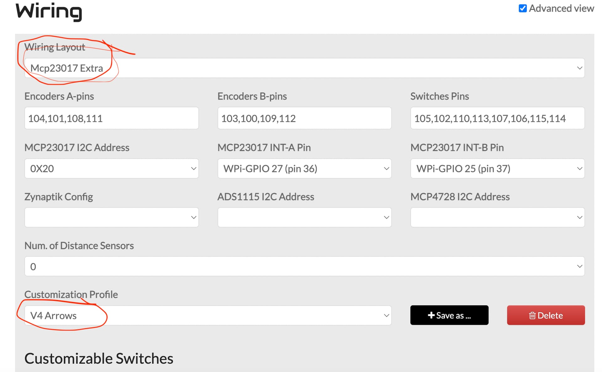

Also, I would like to add a note, that selecting Custom wiring and adding all the pins as on the screenshots above, none of the encoders and buttons worked…
So I picked MCP23017 Extra wiring layout, and it now works korrectly. All the encoders and buttons.
In my understanding Custom wiring should have worked as well.
