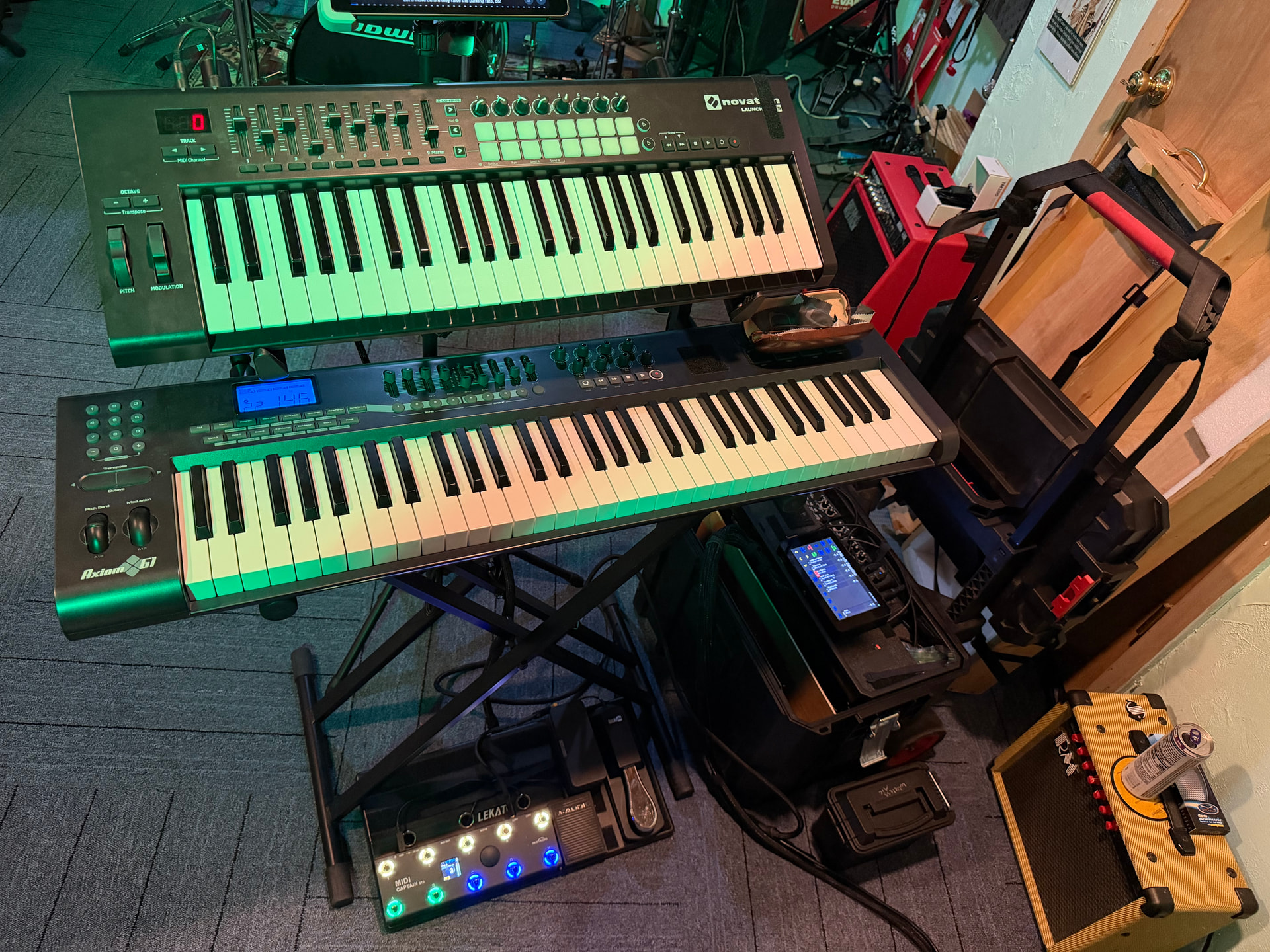

Top line keyboard, bottom line keyboard, 2 sustain pedals, 1 volume pedal, and a Midi Paint Captain for PC changes, and additional CC messages mapped within the controller itself.
Single Touchscreen Zynth, with 5ish MIDI channels defined. setbFree, Pianoteq, Fluidsynth for Brass, Strings, and Horns as needed.

I want the CC from each keyboard routed to the same destination CH# as the notes. I have confirmed in the logs that the CC CH# sent by each keyboard is the same as the note on/off CH# that I have it assigned to. In my picture, MIDI CH#3 is upper keyboard, and MIDI CH#4 is lower keyboard, configured at the keyboard itself.
I was hoping there was a UI option I had misconfigured somewhere that was causing them to be rerouted, but it sounds like that is by design.
