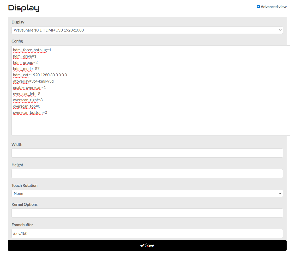

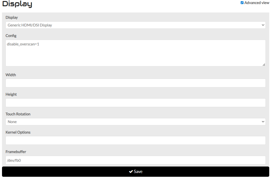

This worked using this setup:
but doesn’t work if I use the setup that matches reolution of my touchscreen (and works in Oram) as follow:
In the other hand:
git checkout 631c645d6e160f58f04c1456b5d368f193aa5cd6
doesn’t work neither using Generic HDMI nor Wavesahare (is the profile that worked for me in Oram changing resolution to match my Minix sf10t).
Another weird things that is happening is, when rebooting, the splash image presented is Oram, despite is branch Vangelis.

I suspect this may be caused by vc4-kms-v3d overlay which significantaly changes the interface to the display. Is this actually required for your screen? This setting enables 3D (kinda GPU) functionality that zynthian does not use.
