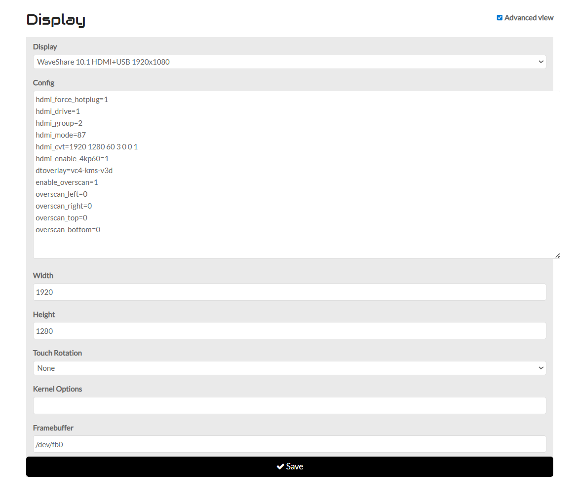

It is odd that you get the problem with RPi500 + mouse. Have you applied config with vc4-kms-v3d or some other config that may also have changed behaviour? (We could be chasing different issues with similar symptoms.)

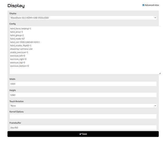

Hi @riban , What you say about KMS driver is correct in Vangelis (on pi 5). By putting this driver in Webconf I can get resolution 1920x1280 that matchaes my touchscreen, but appears touch issue. If I remove driver KMS from webconfig I only can get 1920x1080 resolution but touch interface works properly. I can live with that suboptimal resolution. Keep in mind I’m testing with the previous Vangelis version we talked about yesterday.
Anyway, kms driver works pretty well with my V4 kit (pi 4) configured to use my HDMI+USB touchscreen.
It’s really surprising that the modern KMS driver fails on pi 5 and works on pi 4. I guess Oram and Vangelis are both Bookworm based.
If you need other testing I’ll be available to do it.
