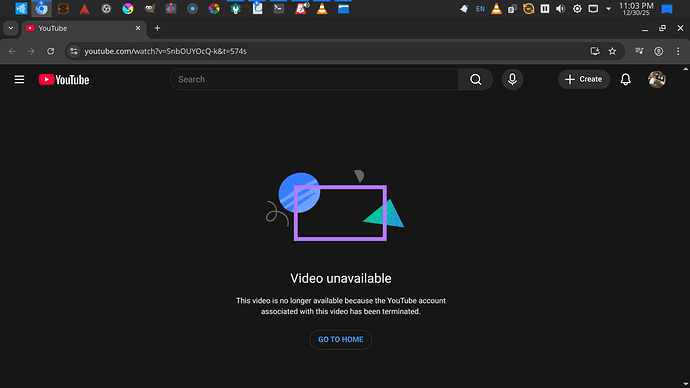

I tried the first video, got:
Video unavailable
This video is no longer available because the YouTube account associated with this video has been terminated.
Nevertheless, it sounds fabulous!
I just removed the videos from the post.
