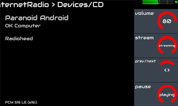

I have a patch for Internet Radio player to add CD but it doesn’t recover from the CD being ejected so needs more work to make this sufficiently robust. But I am able to play a CD and it shows some metadata too…
Neat!
And not just any CD :smiley:

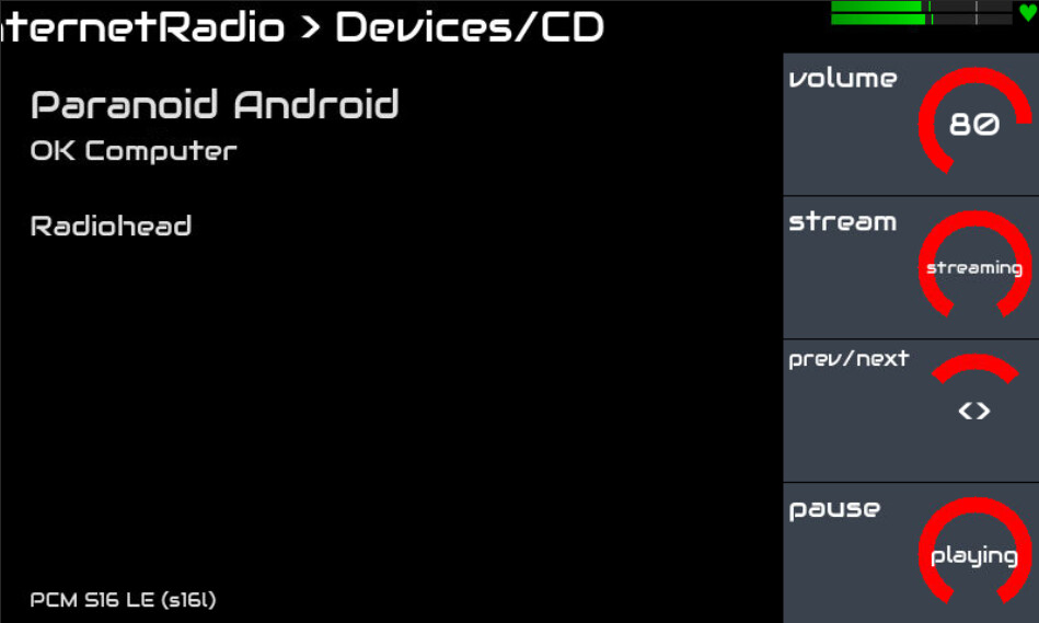

I pushed my patch to Vangelis. It does work (thanks @jawn for proving this) but it is still only a PoC. What works:
  • Detects if a CD drive is connected (only checks /dev/sr0) and shows Bank “Device”, Preset “CD” of found.
  • stream toggles play (from start of track).
  • prev/next play the previous and next tracks on the CD. (Wraps at end, i.e. next from last track will play first track and vice versa.)
  • pause toggles pause/play.
  • random enables random track selection.
Ejecting the CD whilst playing tends to break things. I haven’t looked into this yet. (Anyone else is invited to try to fix this!)
I also fixed some layout issues with the display. The title is now fixed to one line, i.e. does not wrap. It will truncate if too long. (I would like to scroll it but didn’t have time today to do that.)
Info occupies most of the display and wraps text. If it is too long it is likely to bleed into the bottom text.
Bitrate, CODEC and channels are at the bottom of the sceen.

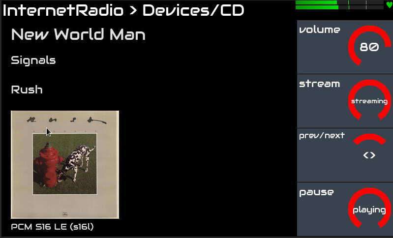

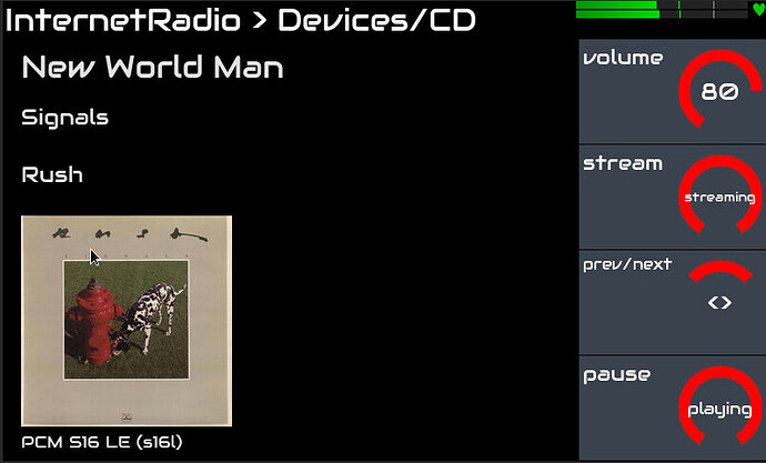

I added code to detect change of disc and also to show artwork if available.
It is not perfect but will do.
