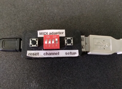

I made a small device to quickly change the Midi channel for my Korg microKEY (it has a fixed channel that takes a PC to change).
It looks like this:

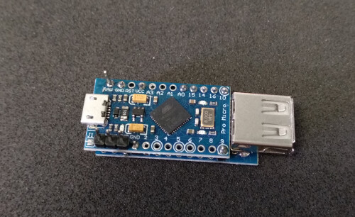

and inside is only this:
It’s an Arduino pro micro, with a mini USB host shield.
It also transforms CC98 to Program Change messages.
To make it send multiple CC messages with some delay between is easy.
But, it takes some soldering and some Arduino programming (working example available :wink: )
Kind regards,
Hans.
