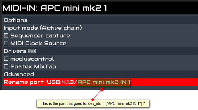

I have set the dev_ids like this:

Can you generate logging messages from your code?
The dev_ids are not always the same as the string shown there.
I forgot how to get the required string, and cannot find it.
You may want to change it to ["*"] to target all devices for the time being, until we figure this out (and document it…).
not exactly sure what this is, but will try find out
Tried it. Even when i put
dev_ids = [“*”]
in the APC40 driver (which is working) no drivers are loaded. i have also tried dev_ids = [*]…
I thank you for your support, i hope that as soon that my driver is actually loading, i will be able to self study my way further for a while.

To sum up:
  • The APC40 driver loads only when in system location
  • The APC40 driver does not load (on any controller) if it’s dev_ids = [“*”] (or dev_ids = [*])
  • The new untested APC mini driver does not load when it’s dev_ids = [“APC mini mk2 IN 1”] or dev_ids = [“*”]
I think that someone said it had to be the right quotation marks. It looks wrong in this post (they are typed not copied here) but they look right in the code - like this: “…” EDIT: when i hit enter they changed to the quote/unquote style. But anyways they are working in the APC40 driver

Is the UI Log in debug mode the one you are asking for?
Now i have the APC40 and the APC key25 working as normal. And i have 2 drivers for the APC min in both /zynthian/zynthian-ui/zyngine/ctrldev and /zynthian/zynthian-my-data/ctrldev.
one with dev_ids = [“*”] and one with dev_ids = [“APC mini mk2 IN 1”] - none of them, are loading…
Niels suggested to get the correct id from terminal, but could not remember how to. @jofemodo , do you know how to extract the exact ID so that i am sure that at least is ok? Under Midi input Devices it states the ID as APC mini mk2 IN 1
Hmm, it seems this should be the right place to look.
https://discourse.zynthian.org/t/launchpad-mini-mk3-driver/9369/2.
You should be able to see the name of the device in webconf: http://zynthian.local/ui-midi-options and select the “MIDI Devices” button which should show a list of MIDI input and output devices.
Thx for all help so far. I must admit that i just found out that it was the APC mini’s port 2 (IN 2) that was the answer so far, i tried to connect to IN 1 since that was for control (i read somewhere). Now the driver is loaded, and i can start digging into the .py stuff.
I will try next time to avoid things like this - i should have checked with both ports :slight_smile:
Nice you got it working. Good luck coding!
Thank you so much for trying to make the APC mini mk2 work in Zynthian :slightly_smiling_face:
