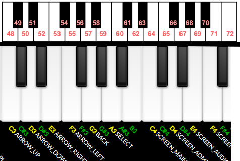

in Webconf it would be useful to add the MIDI note number on diagram
Yes it would! Raise a feature request.
