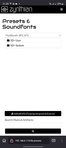

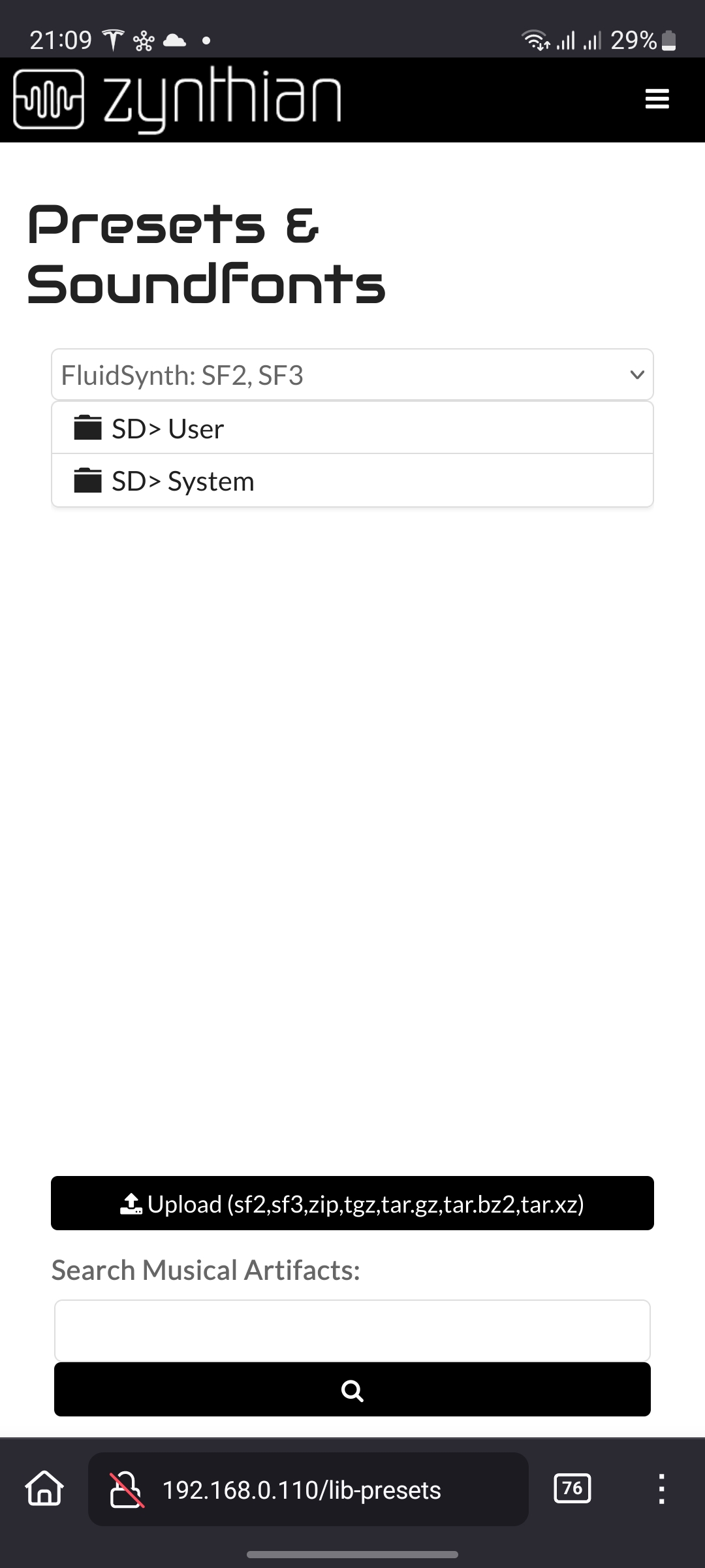

For number 2. Would the upload soundfont functionality of webconf work? I think i have added bigger piano font and it went to user bank. With soundfont editor you can edit the structure how they’re organised so e.g. ones you use most can be changed to appear first.
https://wiki.zynthian.org/index.php/Sound_Fonts
Possibly modifying the soundfont stored as main in zynthian could change the default sound as well solving number 1. I have used polyphone as an editor which was suggested in wiki and it works ok for what i wanted to do.
It would just be stored as a zynthian snapshot. Zynthian UI User's Guide - Oram - ZynthianWiki
