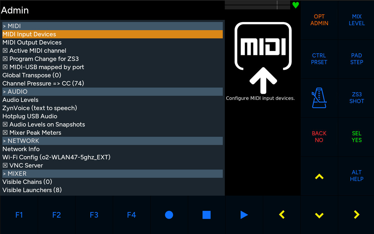

This sounds interesting. Just tried inter, but can you tell which arguments would be accepted? I guess it only takes “Inter” but nothing like “Inter-Light” or similar, right? Right now it seems you can only use a specific variant if you only got one per font family. Or can you specify a path?
Btw, this is “Figtree-Light” and “Figtree”:

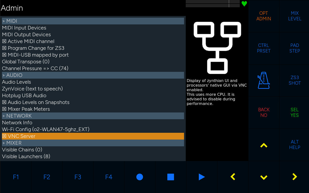

I think it’s beautiful, but in the long run I’d prefer a narrower font (I typically use Abel) for displaying i.e. longer patch names. Otherwise on my 8" 800p display I got plenty of room.
By the way, I see that not every widget uses the chosen font, like the context help section here (or does it?).
