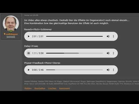

Better sound demo…
Fx sound inbuild to 2.Teensy MCU

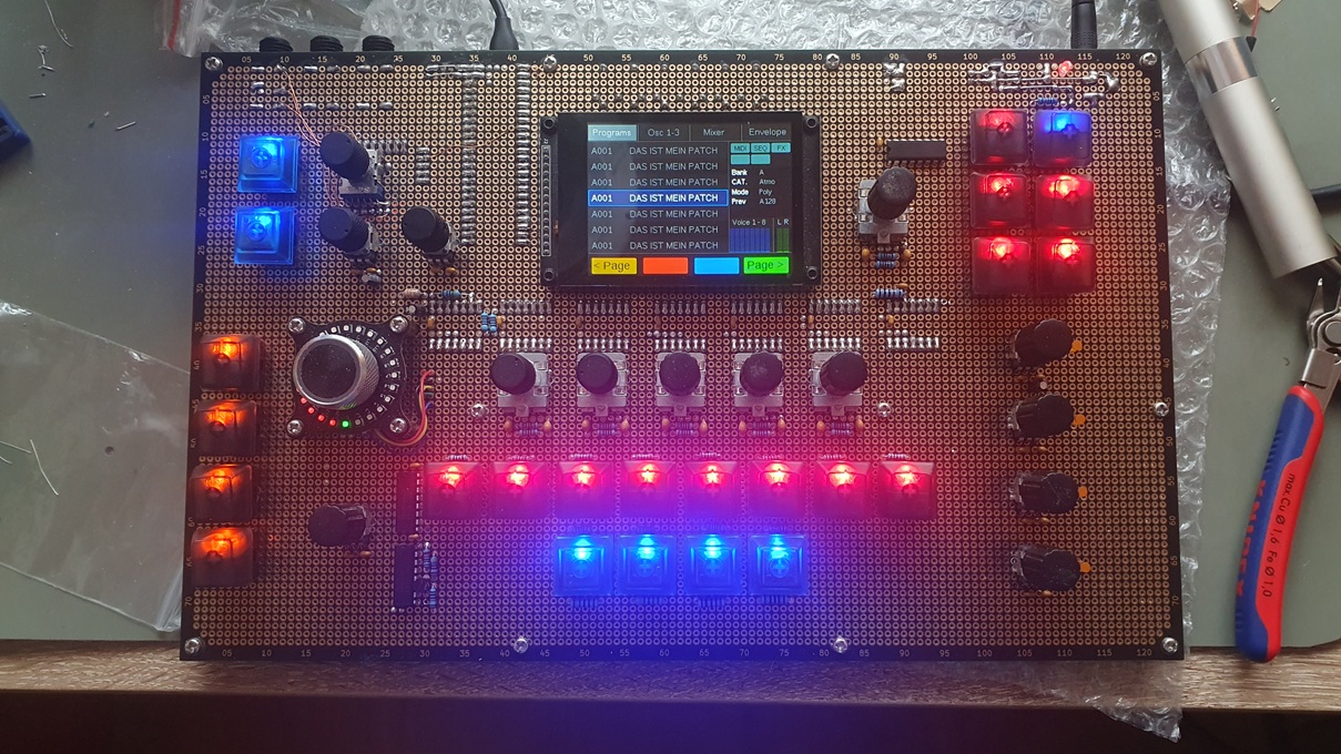

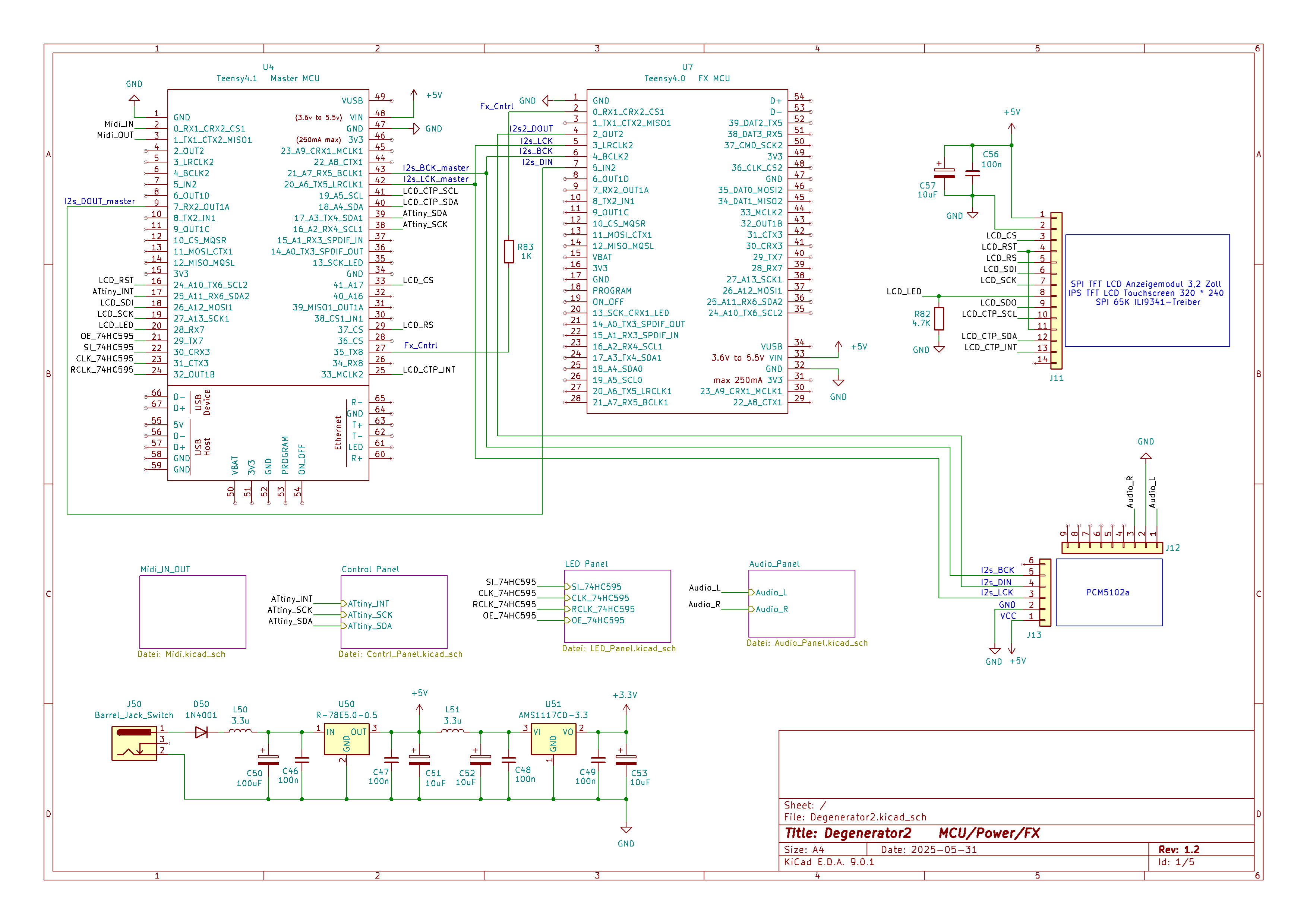

Hardware Degenerator 2

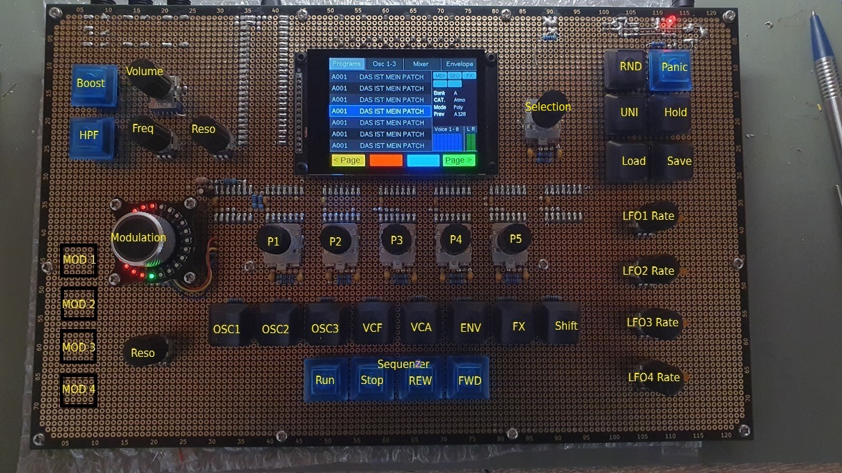

Degenerator2 goes Fairlight CMI..

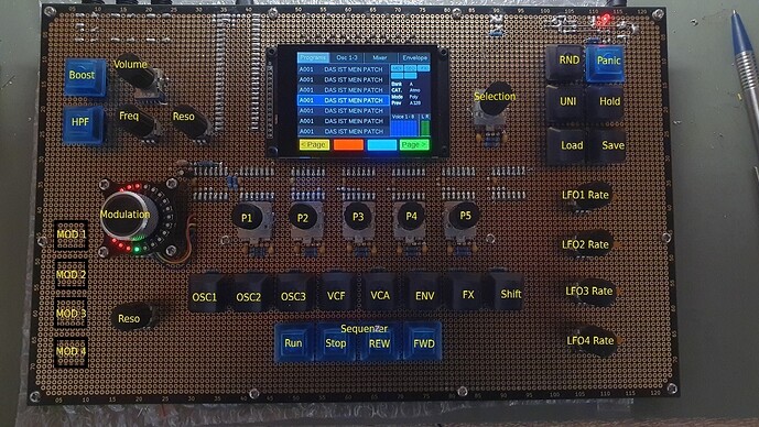

A small update to the file system. The patch parameters are now stored in a JSON file and can be expanded as desired. I’m using the JSON library in Arduino for this. Once again, most of the work is in the details and the graphical user interface.
The next step in Degenerator2’s development is the oscillator section. The oscillators will feature VA Synthes, Wavetable, and Sample Synthesis similar to the Jeannie Synthesizer.

Really nice use of dot board!!
