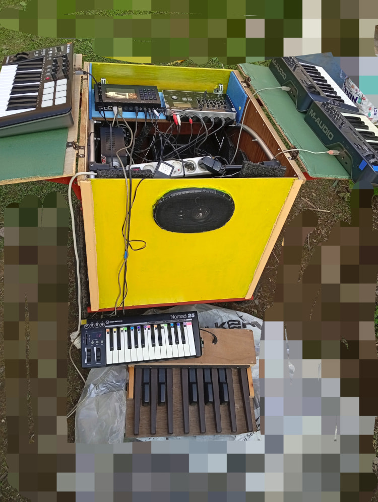

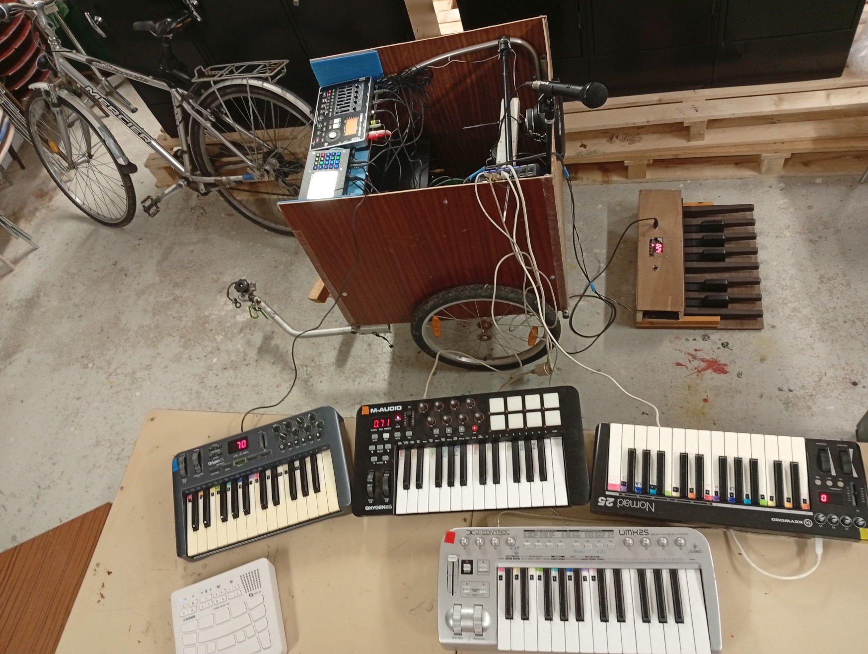

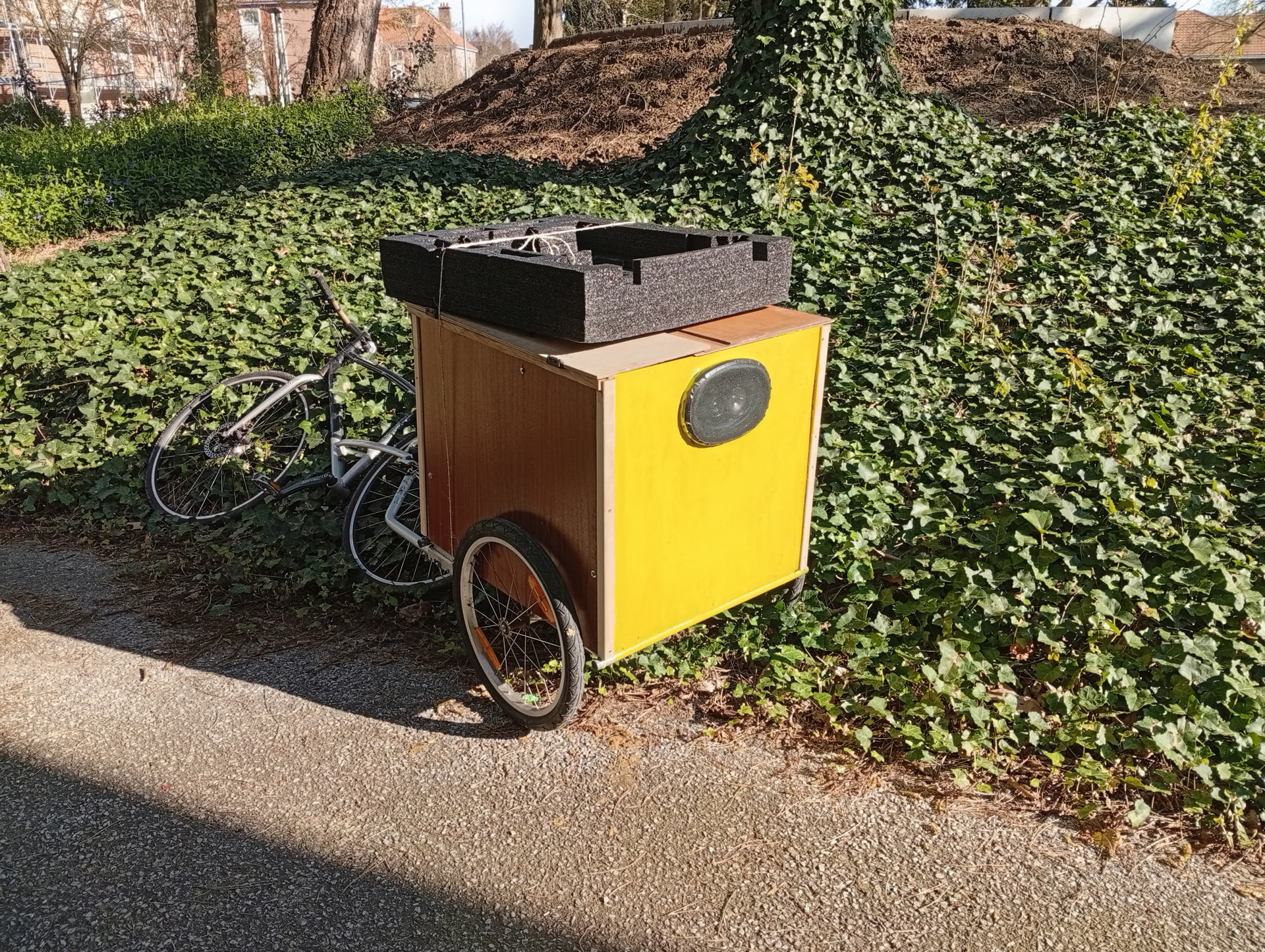

Hello All the Zynthianers, this is a project using Zynthian… I Want to drive music in the musical-desert with a bicycle! The DéliVéloMusique for the fun, I hope that Jean Michel Jarre come with me to turn over the world,… “A Bicyclette”

Ok, thanks, I hope it will have in the future a lot of délivélomusique in the world… this afternoon I paint the ‘car’ … and I want to screen zynthian … can I do it?

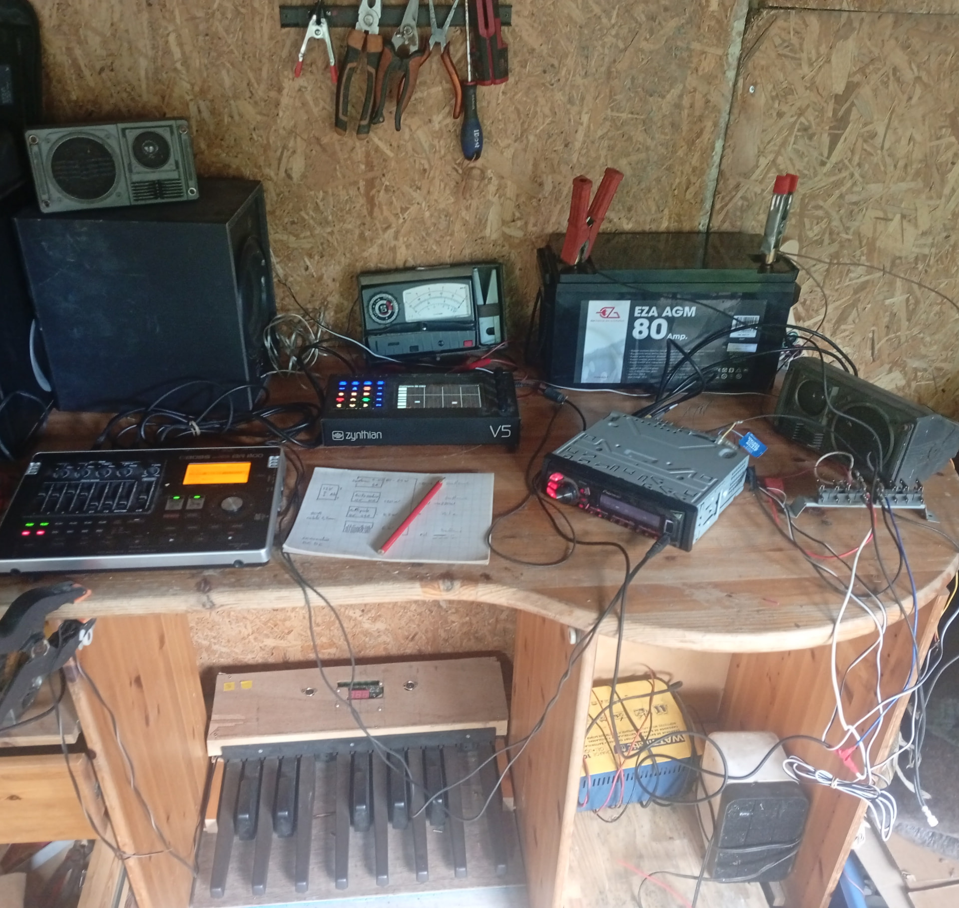

A test on a 12V battery that works. I need to change the subwoofer box card. the boos multitrack, intended for recording, runs on batteries.

Hello friends, I realize, after a day of installation in the trailer, that the car radio does not deliver sufficient power to ensure that the sounds from the zynthian are correctly reproduced.:face_holding_back_tears:
It saturates, it buzzes, it adds strange frrquencies…
Big sounds can require a lot of juice. A car battery is good and modern liPo batteries are even better. But make sure there is a properly rated fuse in line.
You do not want a short circuit.
Personally I used the HifiBerry Amps to drive the speakers.

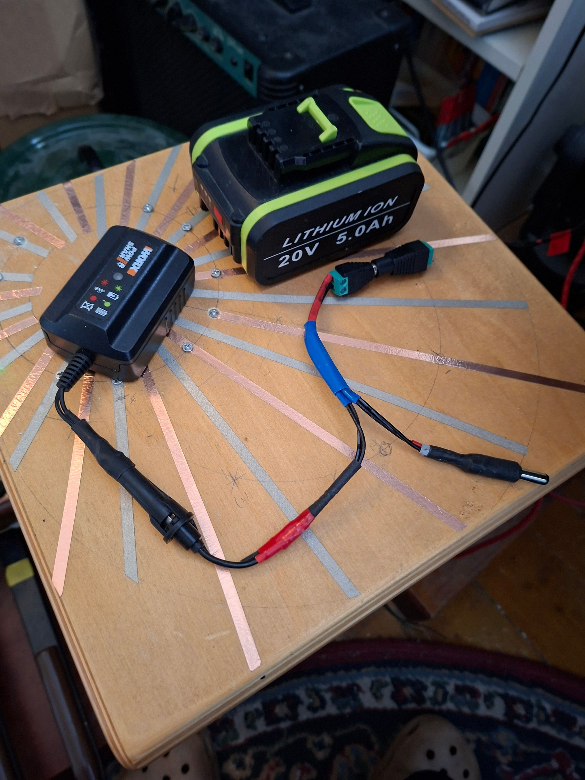

Not used the 4 myself but Iv’e several amp2’s .The match with a lithium battery pack @ 20Volts is optimal.and there’s bags of current there if needed and because it’s class D it’s efficient.
It also simplifies operations by putting the master volume control in as the zynth mixer.
You have no need of an external volume control. You mix from the zynth.
An even more flexible rig is to use the ADC DAC pro with the piggy back amp board.
Which gives you two audio outs that can be passed off to house audio low life to use and abuse as they see fit…
The cajon does this.
But do add the fuse.
Yes wyleu, in fact I’m going to try an auto amp; the soundlab cpa 100N, found on ‘‘le boncoin’’ … it seems that you have to filter the bass so as not to go below 50hz : with Norauto 15-23cm 50W speakers…,
for power I’m taking a 12V slow discharge 80Ah battery while waiting to find something lighter…
