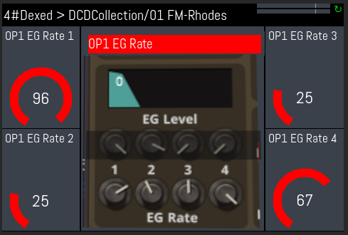

One other idea that might ease the usage on zynthian is if we had envelope visualisation for the special way dexed does this:
And on the levels pages the rate params greyed out.
Note that the values in the image do not correspond because of two different instances of dexed on two systems, and I did not feel like adjusting it to fit.
