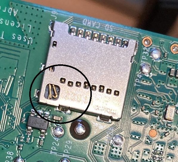

Did I damage the SD card slot? (SOLVED)
Did I damage the SD card slot, or is that the case with the Raspberry P5?

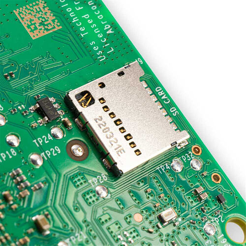

haven’t looked at mine but the pics i found online suggests it looks like on your picture, why though - I don’t know..
Maybe it’s sort of a clamp to tighten the card in the slot?
Thanks @funginum , it wasn’t reading any SD cards anymore, so I noticed this, but in reality, a terminal on the power wires had come loose. It wasn’t enough to shut down the Raspberry Pi, but it did halt any attempts to read the SD card.
