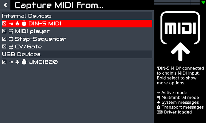

By default, each MIDI input is set to Chain Mode which will play the currently selected chain. You can change each input to be Multichannel Mode so that it plays the chains of the MIDI Input.

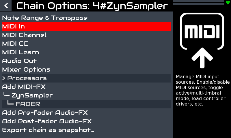

Bold press with Select encoder on the appropriate GUI chain get you to the Chain Options.
Capture MIDI from… is where you choose the appropriate response to the MIDI Device.

When you get to the options of a chain, by bold-pressing on it in the mixer view, you are showed the Midi In menu, where, again by bold press, you can choose whether the instrument loaded in the same chain responds to whatever incoming Midi channel is sent to the currently selected chain (chain mode aka active mode) or the Zynth functions multitimbrally, as a 16-channel Midi expander.
Please, be advised that the multitimbral operation is signalled by a graphic logo with parallel horizontal arrows, and that, once enabled in a chain, it affects any other Midi tracks of the current snapshot.
Therefore, you can only operate in full active of full multi-timbral mode, at least as far as the current Oram stable release goes.
