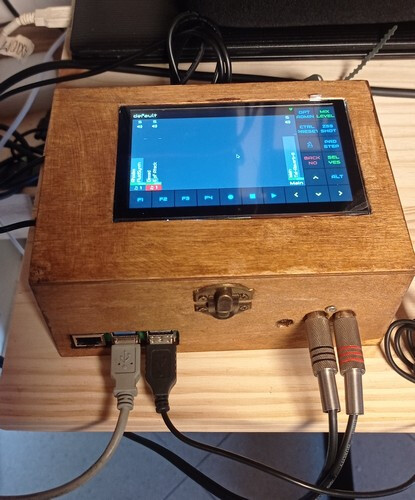

I built a DIY Zynthian and I would like to rotate the display of 180 degrees for a better usabilty of my gear.
I would like to have connectors in the opposite side but unfortunately I cannot rotate physically the touch screen because screen connection strip is too short.

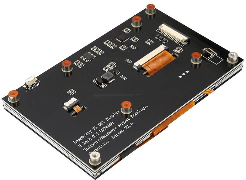

So, my touch screen is a DSI capacitive LCD TFT 5” 800x480 set as is set Generic HDMI/DSI Display

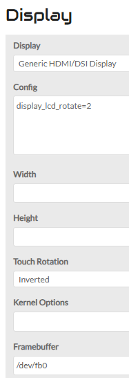

I also tried to other way with Generic HDMI/DSI Display
rotation: inverted
–> no success
display_lcd_rotate=2
rotation: inverted
–> no success

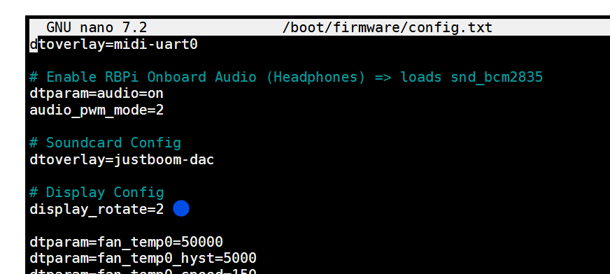

I did it:
but nothing changed

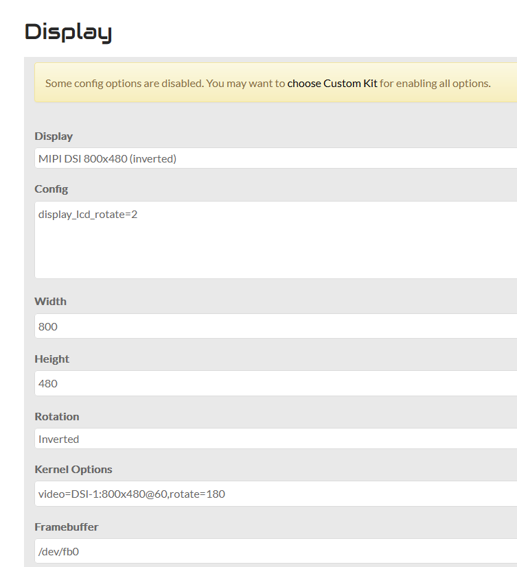

Touch can be rotated with webconf rotation option in HARDWARE→Display.
@piattica I think you have plugged your screen to DSI-2 connector. The advice in the thread has been for DSI-1. You could either swap the physical connector to DSI-1 or change the configuration in webconf to DSI-2. There may be preset configurations available in the drop-down ”Display” field that suit you if using DSI-1.
[Edit] I have added a table to the wiki page describing each field in webconf Display page. There could be room for improvement in webconf, e.g. we could do similar to audio, where changing a parameter will populate the relevant fields, but this will require a good understanding of how each device is configured which is beyond my capacity at this time.

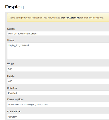

finally solved! :ok_hand:
I confirm to @riban that previously my LCD was connected to DSI-2 connector
once changed phisically the connector to DSI1, all settings became effective:
