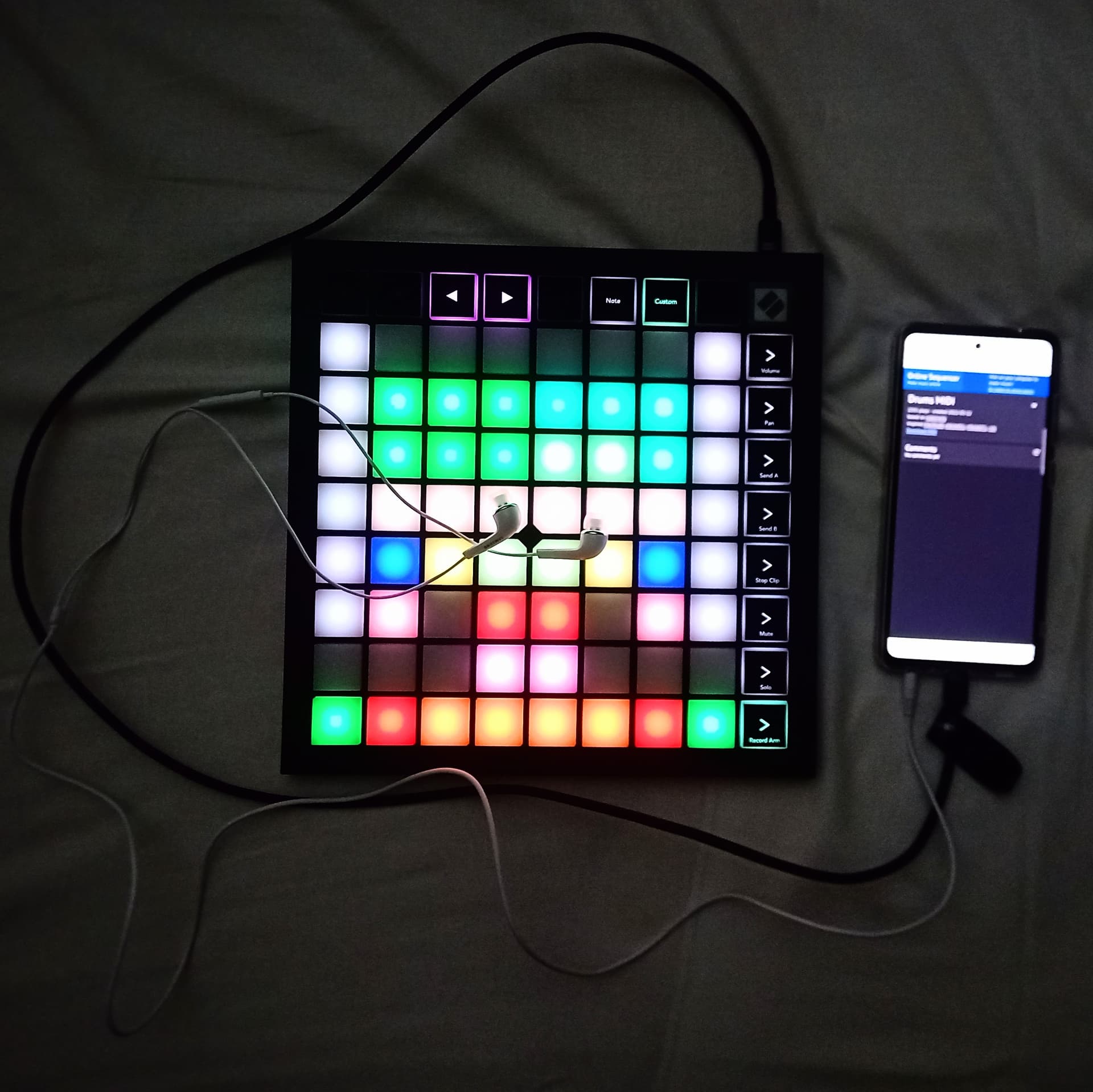

Hello there… I do use DrumGizmo in finger druming and it work GREAT ! But it’s okay to use an other engine if it’s even better.
Not latency with raspberry 4, but 90 seconds of loading-without-touching .
Hi-Hat is close or open in two different midi note, there is no variation at all implemented because … Drumgizmo is not made to be a live setup, there is no recorded sound either of mid-range Hi-Hat
Ps: and so, it’s not the only topic about drumgizmo and zynthian :wink:
