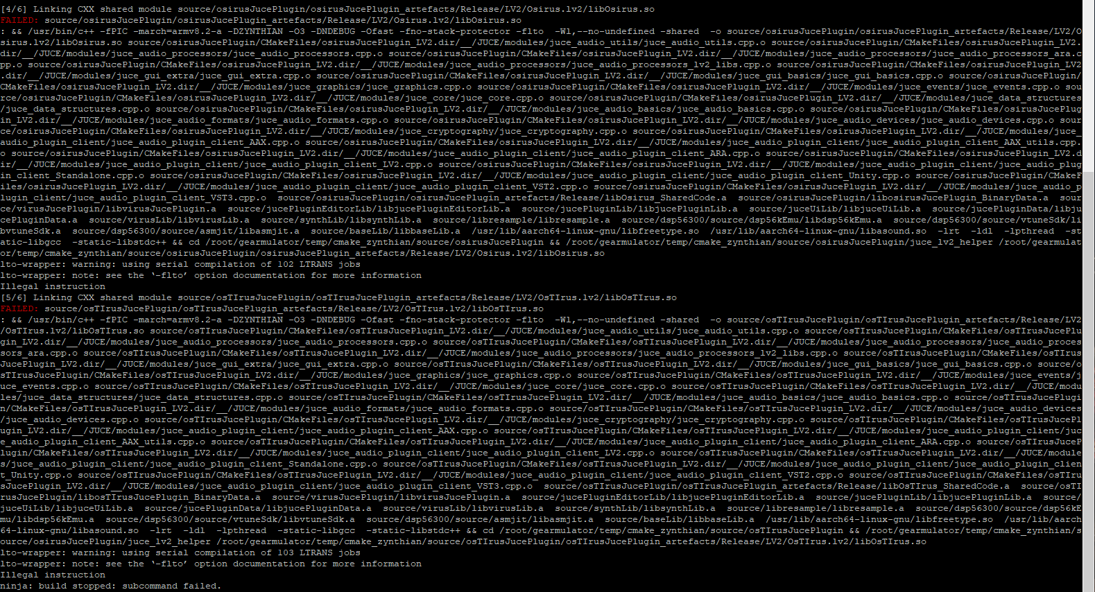

Hi, trying to compile it all and failing :frowning: Any advice (running the latest stable Zynthian build).
Is this a Z 5.1 i.e. a raspberry pi 5 inside?
