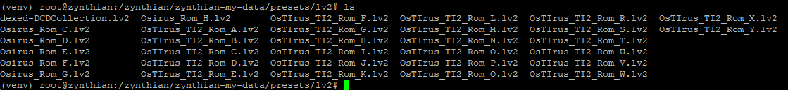

Yes, if you pull and compile the latest version from source, presets are generated upon initial load of the plugin. Presets are written to the folder
/zynthian/zynthian-my-data/presets/lv2
It looks like this:

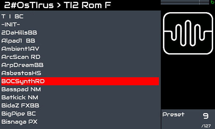

However, they are not picked up by the Z GUI immediately. You have to load the plugins once, then do:
regenerate_lv2_presets.sh http://theusualsuspects.lv2.Osirus
regenerate_lv2_presets.sh http://theusualsuspects.lv2.OsTIrus
And then load the plugins again so that they show up.

Thanks: I very much look forward to recompiling OsTIrus from source, and enjoying the presets directly onboard the Zynth!

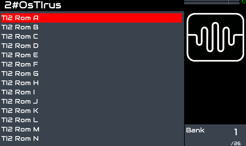

The presets for bank a and bank b are missing in my Zynthian Osirus.

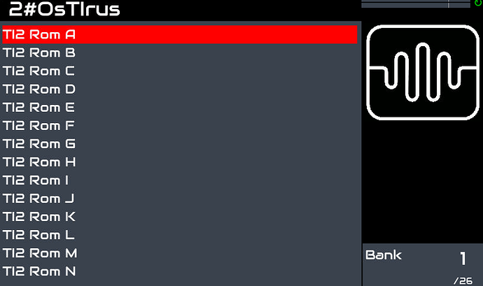

After adding the respective ROMs in the plugins’ folders, searching for new engines in webconf > engines and flagging Osirus and OsTIrus to activate them (with reboot), I can see the new plugins in the Z (latest Oram, V 5.1 with Pi5) [SOLVED but no presets show in the UI of the related mixer chains.]
