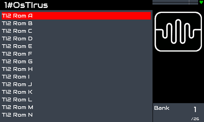

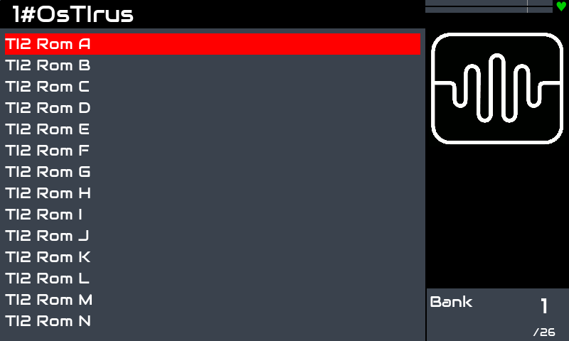

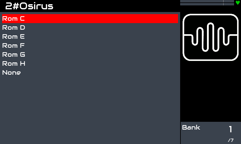

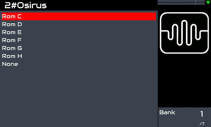

Please, ignore my previous note about not being able to see the generated presets of Osirus and OsTIrus, because (SUCCESS!
) I found the way to have the Zynthian see them after the plugins’ compiling and installation!
It dawned on me that, after the presets generation through terminal commands, the user needs to search (again) for engines and then search for presets in webconf > engines, for Oram to show them in the Zynth’s UI, as it finally turned out to be the case (see screenshots attached).

I see you also don’t get Banks A & B in Osirus. Something is wrong with this 2 Banks. Perhaps a bad character in the TTL…
Yes, I noticed that (missing A and B Osirus banks), and also the Ostirus presets generation reported an S bank error (a missing character apparently), but most of the patches seem there.

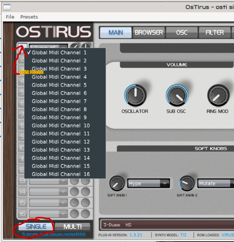

I’ve also noticed the “only on midi channel #1” issue, that obviously poses a problem with running more than one instance e.g. OsTIrus and Osirus concurrently.
I’m running PI5 with no overclocking and hdmi audio @ 512byte buffer. No noticable lag, and no issues with the virus plugins.
in the second instance of Ostirus/Osirus you have to change the midi channel via VNC, right-click on the input and select the channel you need, e.g. ch2.
Or switch to multimode via VNC.
I have saved two presets via the Zynthian UI, Multi and Single, which I can use to call up the basic states Single and Multimode from the Ostirus plug-in.
You can do the same with switched midi input channels.
