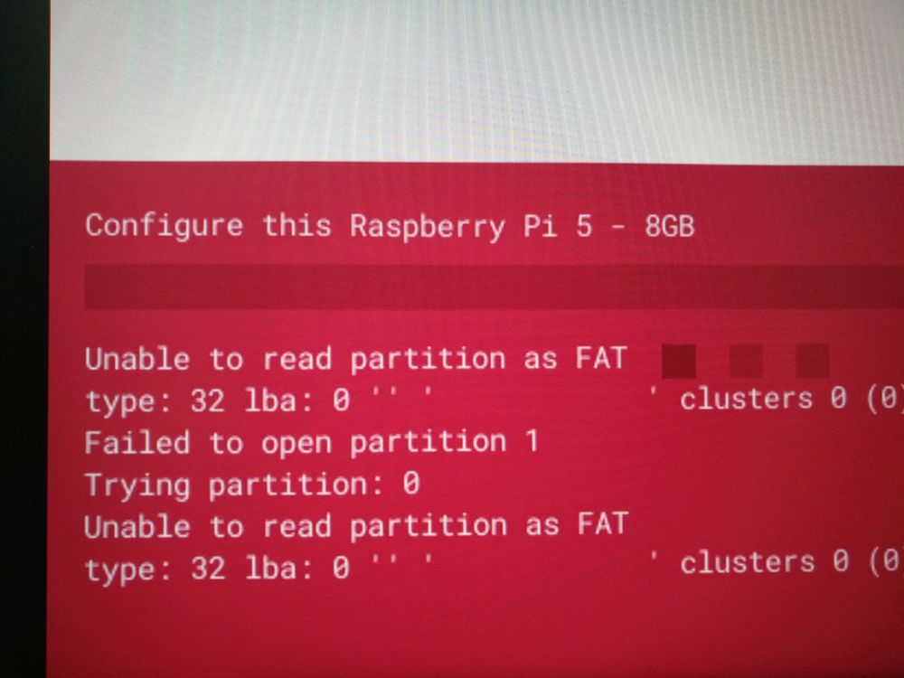

@piattica That’s another thing you can do, connect an HDMI cable and see if the RPi is starting..

When I check the non-working SD card with fsck, several problems are detected. If you see these, there’s no point in using the repair options. It’s better to reflash the card.
(venv) root@zynthian:~# fsck /dev/sdb1
fsck from util-linux 2.38.1
fsck.fat 4.2 (2021-01-31)
There are differences between boot sector and its backup.
This is mostly harmless. Differences: (offset:original/backup)
  65:01/00
1) Copy original to backup
2) Copy backup to original
3) No action
[123?q]? 3
/config.txt
  Contains a free cluster (121952). Assuming EOF.
/config.txt
  File size is 2331 bytes, cluster chain length is 0 bytes.
  Truncating file to 0 bytes.
/cmdline.txt
  Contains a free cluster (121954). Assuming EOF.
/cmdline.txt
  File size is 201 bytes, cluster chain length is 0 bytes.
Reclaimed 3 unused clusters (6144 bytes).
Dirty bit is set. Fs was not properly unmounted and some data may be corrupt.
1) Remove dirty bit
2) No action
[12?q]? 2
Free cluster summary wrong (227207 vs. really 227209)
1) Correct
2) Don't correct
[12?q]? 2
*** Filesystem was changed ***
The changes have not yet been written, you can still choose to leave the
filesystem unmodified:
1) Write changes
2) Leave filesystem unchanged
[12?q]? 2
/dev/sdb1: 438 files, 33906/261115 clusters
