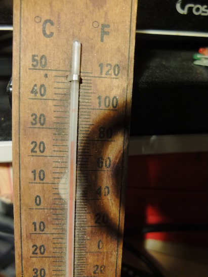

Ahhh… ok… start to make a little more sense…
unlike my mercury temp meter… it seems
a little vague between 80 and 100 fahrenheit…
It’s 10 PM and all windows are open…
It’s definitely not 80°…

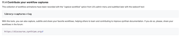

The work flow tool is a excellent tutorial aid that would benefit us all if frequently used.
