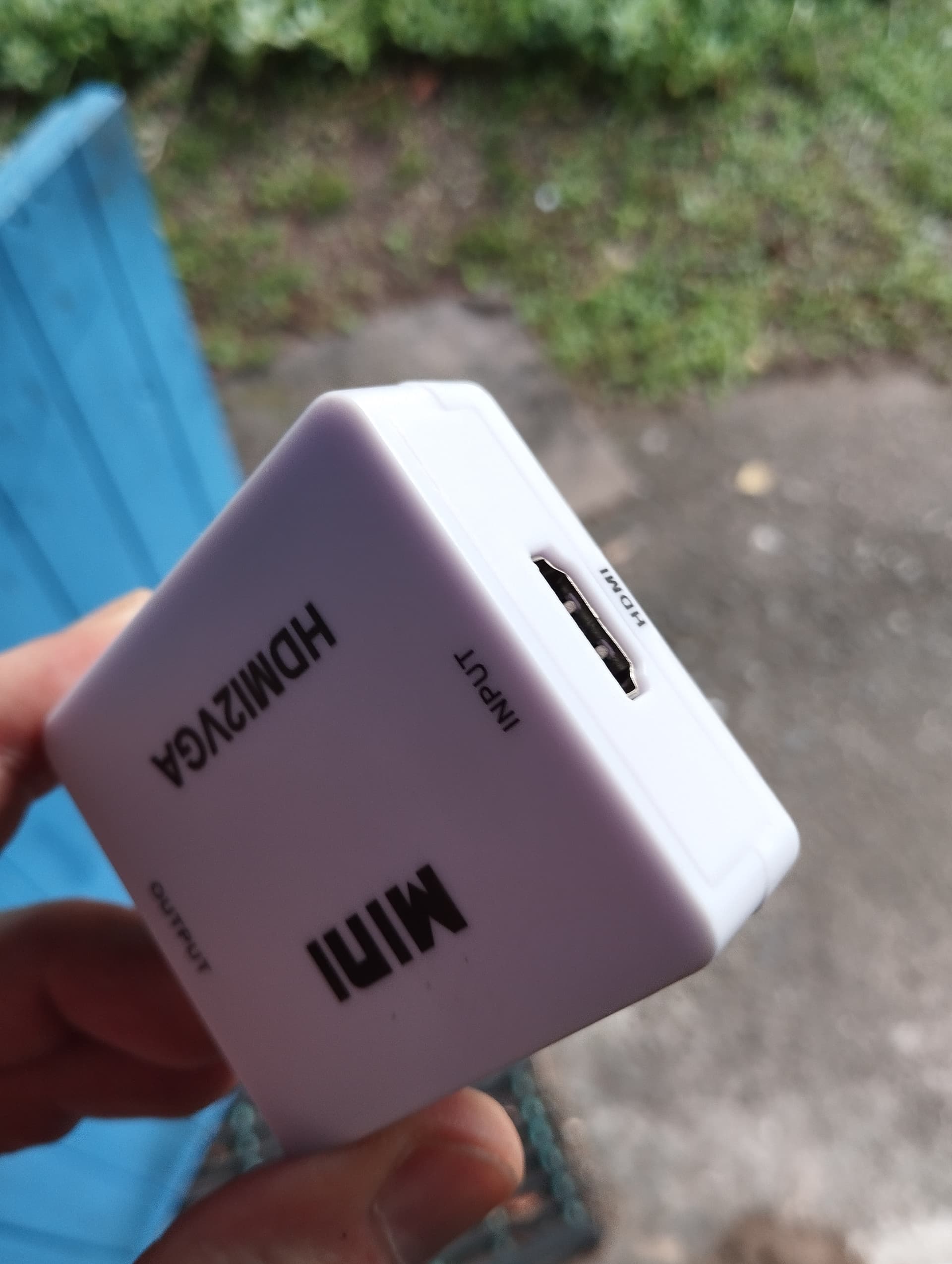

This is my temp fix, works with hdmi power and is available in africa

on the pi5, my hack is to use that little bad boy above, and there’s going to be a patch very soom that will let you get it on, we’ve tested a command line workaround in the thread and the ui did start up, so all is not lost, it’s going to happen, and if you can get an hdmi to vga adapter, it will serve as a workaround in the meantime
