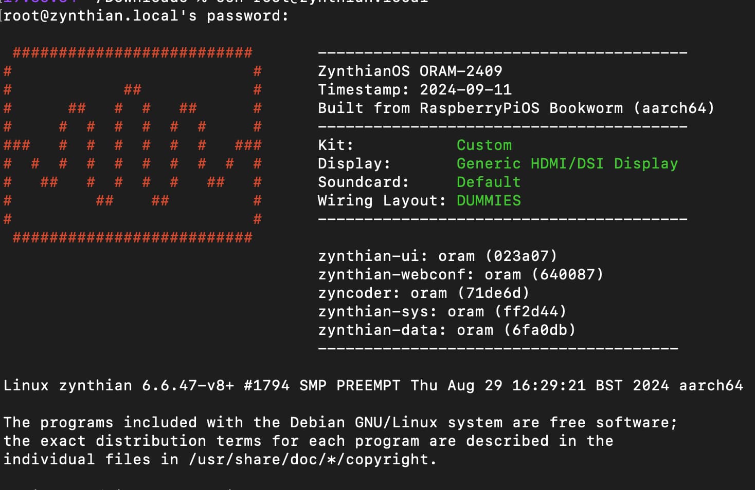

In a terminal. You can access terminal from webconf INTERFACE->Terminal, or you can use an ssh client to login as root with password opensynth.

i have same situation but on a pi4: connected with hdmi to a large display (no touch), it works with raspbian, i also can see the display working when removing the sd, but with zynthian i get a black screen, even after 15 minutes. I tried both stable and “testing”, tried changing hdmi port, web interface and ssh are working.
My display is a 4K, and i tried adding to cmdline.txt the following
video=HDMI-A-1:1024X760M@60D
video=HDMI-A-1:1920X1080M@60D
video=HDMI-A-1:3840X2160M@60D
