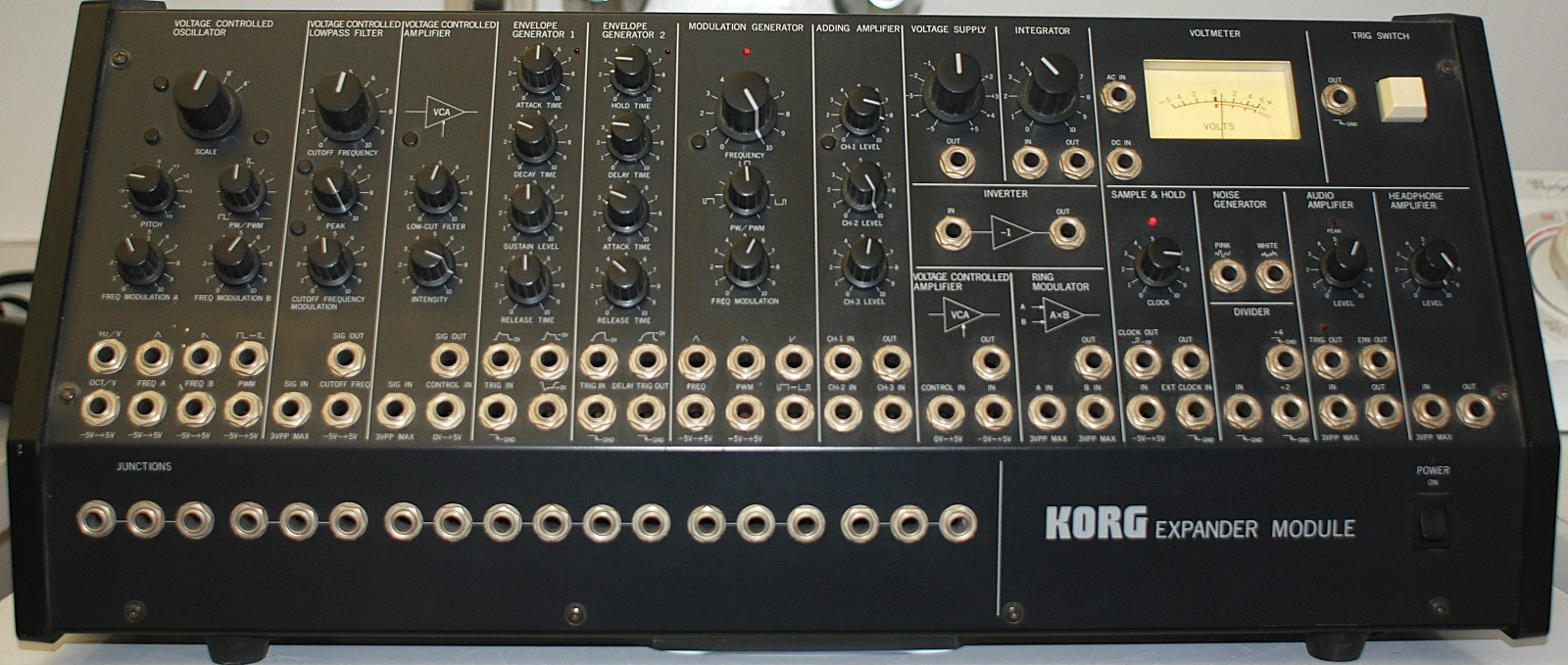

There is the expander unit the MS-50 that does feature a ring mod. My mate Stevo had both.
