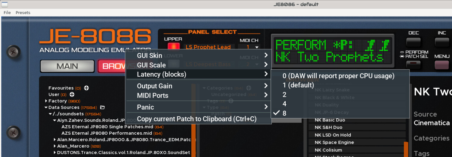

I got rid of the audio crackling of the JE8086 with noticable delay in play response.
I put the latency blocks to 8!!
This needs to be done in the user inteface of the synth via “http://zynthian.local:6081/vnc.htm
Makes me happy I found this :smiley:
Now looking for making this setting permanent, so I do not have to set it manually all the time.
Cheers and happy music making!
Maarten
PS It is automatically updated in the config file:
nano “/root/.local/share/The Usual Suspects/JE8086/config/JE8086.xml”
PPS The other Usual Suspect synths also have the latency option :smiley:
