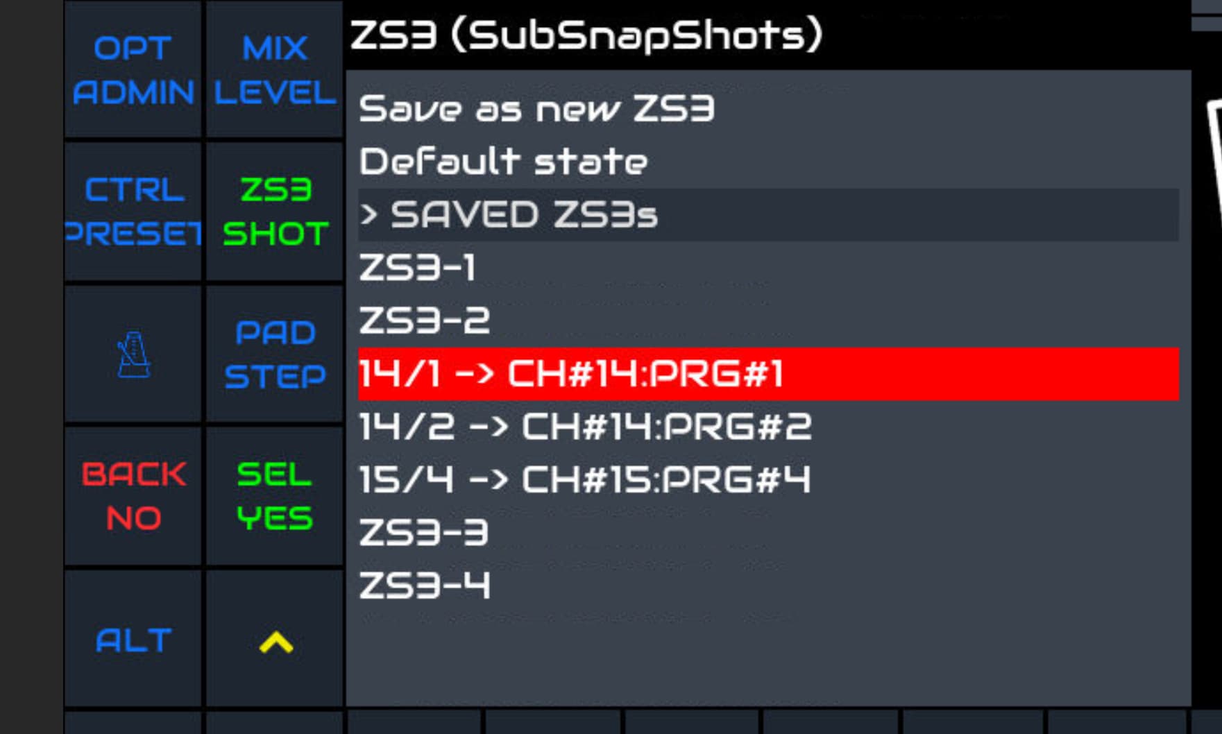

Hi @Aethermind ,
I think for ZS3 your description is almost right. Except that for ZS3, PC’s can be received on the MIDI channel that is received when on the ZS3 page in lerning mode. Also, on the Admin page, “Program Change for ZS3“ needs to be activated.
So when you have 5 ZS3 subsnapshots numbered from 001 to 005. You can select then individually by any channel and PC that is received when a ZS3 subsnapshot name is selectedon the ZS3 user screen. It does not matter to which MIDI channel is defined for the Snapshot itself.
In the picture below the Snapshot receives MIDI on channel 1 and PC’s on channel 15 and 16.
Cheers,
maarten
PS…. It is all ‘Absolute‘ adressing. The number of the PC is selecting the ZS3 with corresponding number.
PPS The shown MIDI channel nummbers on the UI have confusing numbers; they are one number lower than expected. (depends on whether the first channel is defined as 1 or 0). This is mixed up in the Zynthian UI interface. So in teh picture you see PC on channel 14 and 15. In fact they are channel 15 and 16.

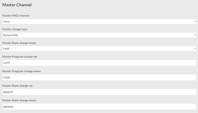

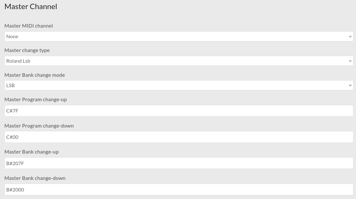

Hi @maartmaart !
Regarding the snapshot selection using Master MIDI channel, please note that there are 2 pre-defined configurations that show how to configure:
Well, indeed it’s quite confusing, but we can try to put some light into this:
  • Roland MSB => Use bank MSB in Master MIDI channel for bank change. Program change for snapshot selection.
  • Roland LSB => Use bank LSB in Master MIDI channel for bank change. Program change for snapshot selection.
Both configs work like this:
  • Bank 0x7F is reserved for positive incremental change
  • Bank 0x00 is reserved for positive decremental change
  • Program 0x7F is reserved for positive incremental snapshot change
  • Program 0x00 is reserved for negative incremental snapshot change
  • The rest of bank & program numbers are used for absolute selection.
I’ve not tested recently, but it should work. Please, check again and give feedback.

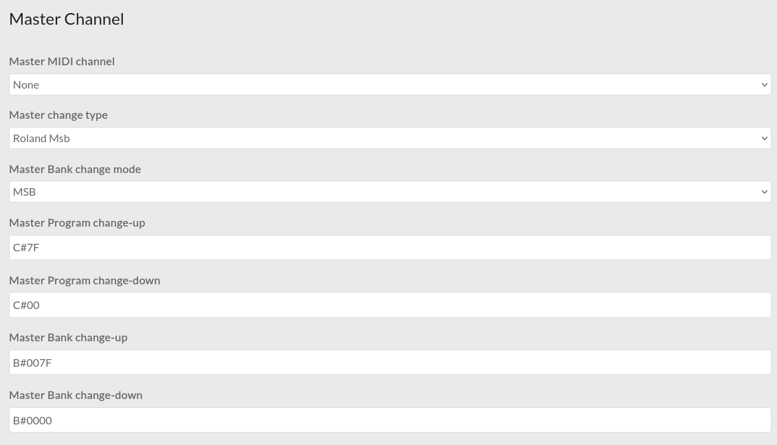

Good morning @jofemodo ,
Thank you for your reply. Unfortunately I do not get it to work :face_with_bags_under_eyes:.
Selecting a snapshot by a fixed number works, but not incremental/decremental.
Also I do not really understand your mail…
What I understand is the foolowing:
  1. In the screen pictue the Master MIDI channel is not defined. I think this is mandatory? For me selecting a snapshot (absolute by number) only works when there is a channel defined… I use channel 16
  2. I think that ‘C#7F’ stands for ‘Program Control Number HEX 7F’ = 127 decimal? So I need to fill in 127 in my remote controller for program change number…? This does not work. When I fill in 0 (zero for decremental) then something happens… the message on the screen indicates that a snapshot is loaded but the current snapshot is stil loaded. (I think it wants to load snapshot number 0 (zero) ?) . By the way, Absolute selection is independent from the selection for Master change type ‘Custom’ or ‘Roland MSB’.
  3. What is ‘Bank 0x7F’? Is that a Program change number or Control Change number?
The ZS3 remote switching works but unfortunately also only absolute… no plans for incremental/decremental ZS3 change?
I am stil fumbling in the dark … :rofl: :thinking: :partying_face:
Enjoy your day. Cheers,
Maarten
