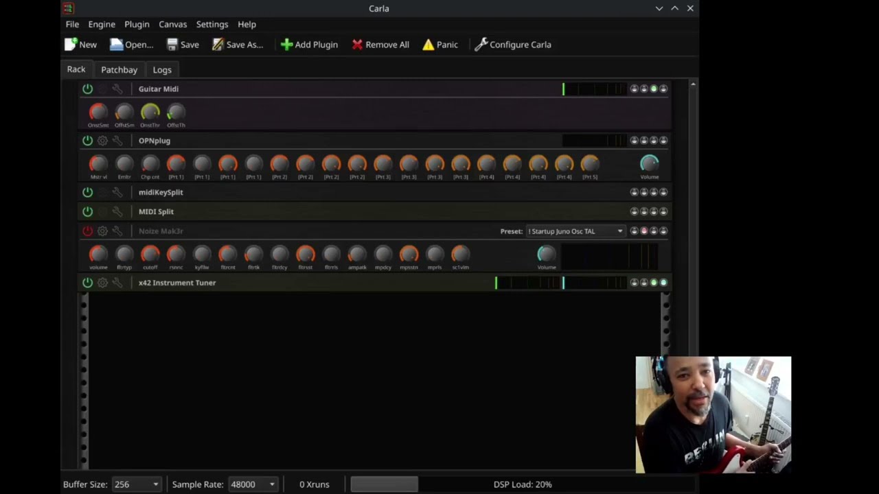

New video released https://www.youtube.com/watch?v=EQhcgh-e5gY
I use GuitarMidi-LV2 to play the Protein synthesizer with my guitar
Get the plugin for linux at
You can donate to keep the development and the channel going:
