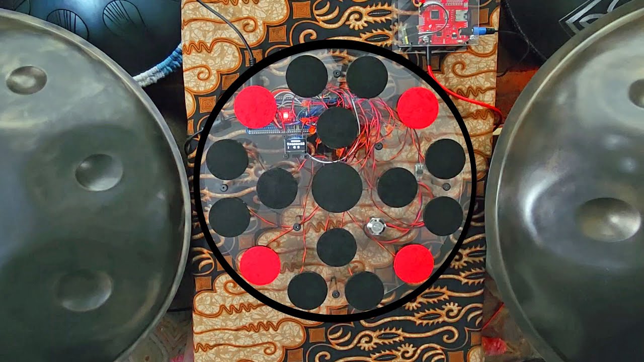

I wish to share you this video since a while :
Because it looks great, seem easy to make, and sound great !
But the sound engine is not on Zynthian, and I like the sound,all the sounds.
Do you know an equivalent of her PanDrum vst ?
See ya !
From the video description they’re not using a vst but triggering samples.
If you can get the samples you can create an sfz soundfont and load it into linuxsampler or sfizz.
Like to know about how they are doing the physical multi element trigger. From the appearance above each pad is an individual connection to something, presumably an Arduinoeque device.
