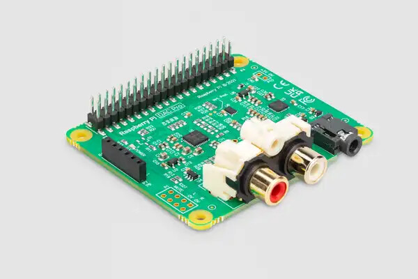

I was curious about this question as I use the IQAudio/Pi DAC Pro with the RCA outputs going to PA and trying to get my headphones at a reasonable level.

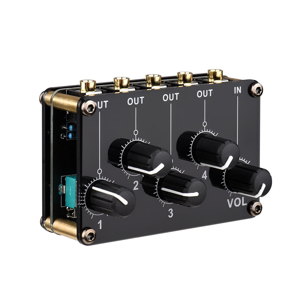

I bought one of these small passive mixers for another problem but I think it now has a new purpose in life. The headphone out from the DAC Pro drives my headphones very loud so I think this could work well.
