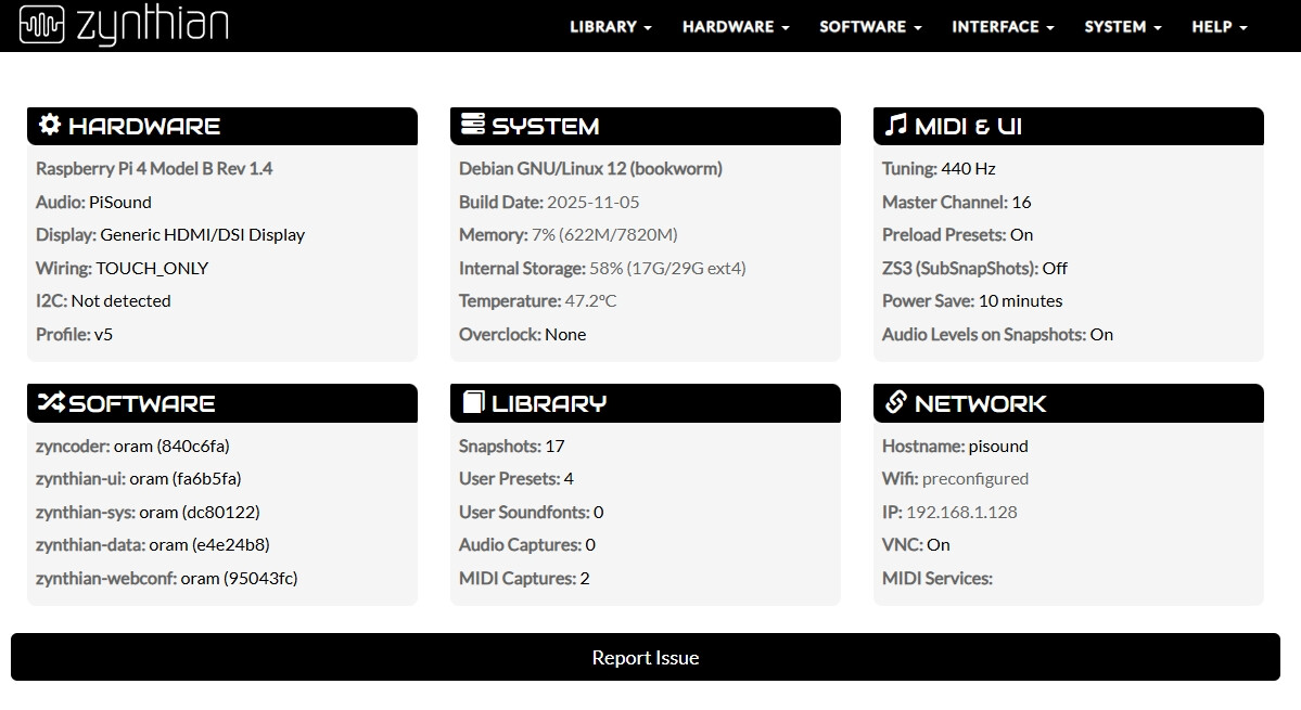

Hi @jofemodo
On oram (staging).
On the webconf > UI Midi options > MIDI devices
I see the input and output MIDI list now has per channel devices, is this a related change?

Nothing changed. It was always like this.
Sorry about the false alarm. I hadn’t noticed the ZynMidiRouter entries before.
