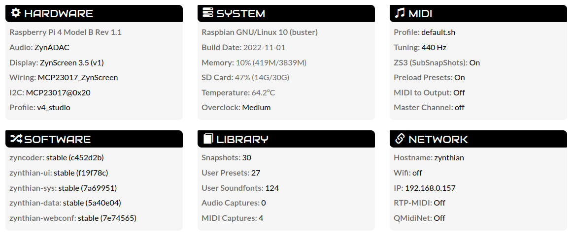

This is my current hardware/software setup:
Has anyone an idea?
