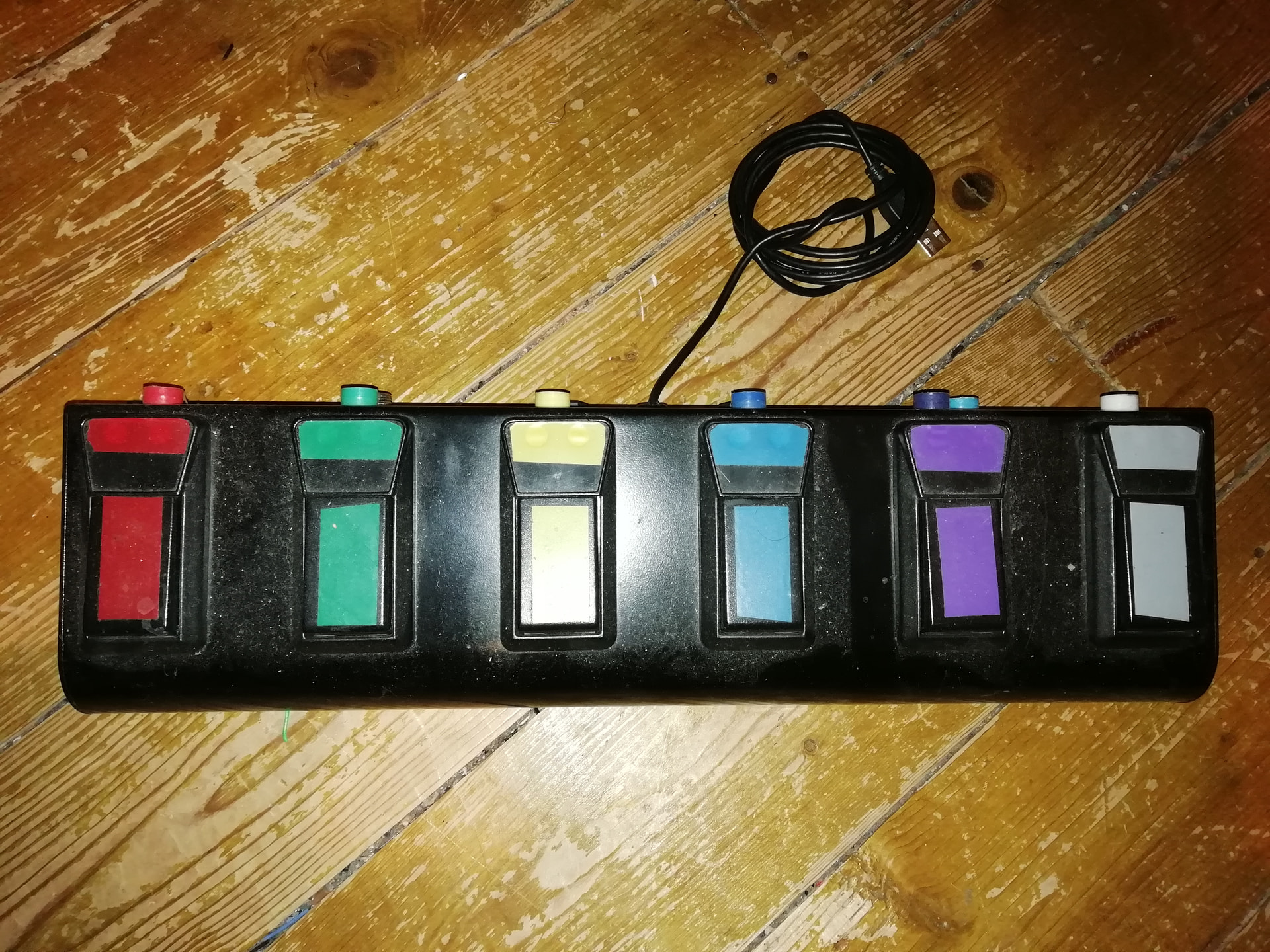

I did it with a converted Bugera footpedal board and a Blue Pill STM32 chip. Even managed to drive some WS2813 RGB LED’s which echoed the overall colour scheme. . .
It did it with generating MIDI values.
I had plans for zynthian ctrldev, but I discovered the reason the pedals were so cheap was because the switches didn’t properly make it they were tilted. Took the wind out of the project .
If you want to do things via USB Blue Pills are good but I now prefer Pi Picos. Either will allow you to open multiple usb components so you can have a QWERTY Interface, MIDI & UART all over the same USB connector, and still programme it that way in the Pico’s case.

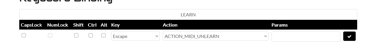

Are we talking about sending MIDI CC, triggered by a computer (not musical, e.g. QWERTY) keyboard using Keyboard Binding? This is already possible, although the syntax is odd (and probably flawed)!
Action = ZYN_CC
Params = CHAN, CC, , VALUE
The same value is sent on press and release. This feels like an implementation for something else from which the keybindings benefits so may not be optimal - but see if it gives you want you want.
Is that an empty third param?
And yes, this is what we are talking about.
I put a dummy value in but empty should also work. The code around this is a bit odd so I had to work out a config that would work with the code. We may tweak the code to be more sensible if we agree a requirement that does not break other workflows.
[Edit] The 2nd param is the press value. The 3rd param is the release value. Nothing to change. It works as requested. I just didn’t understand the way the code was written.
